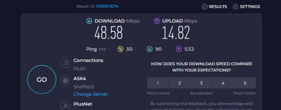

what are your pings like at the moment and can you run a speed test over a wired connection for us too please?
 Adam Walker
OryxCallotis
Posts: 45
Registered: ‎31-07-2016
Re: PlusNet thinks I'm already on Full-Fibre
My download speeds used to be around 70Mbps or so. Not really that bothered if I'm getting FTTP though.
My pings to cloudflare/google DNS/BBC all used to be around 14-16ms (consistent) and now they're about double (consistent).

Cheers for that, line tests are showing speeds are below estimates too.
We just need to do some checks on your set up as a matter of course for the next step.
We can do that by giving you a call and going through an app called "Rescue Lens" which is usually the quickest way so let me know if that works for you.
