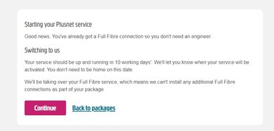

Was looking at upgrading from FTTC to FTTP for my flat, but PlusNet seems to think I already have it;
The building I'm in does have its own connection (wi-fi on each floor) that the landlord upgraded recently, but my own flat on the ground floor has its own separate phone line. As far as I know, I would still need someone to come round to replace the phone line in my flat with one of those grey boxes, right?
It did say I would need to have an engineer coming when I checked a couple months ago (before the landlord upgraded the main building), it's just different today. I'm guessing someone really would need to come over, unless they changed how FTTP works now? It just gives no option to set an appointment or anything.

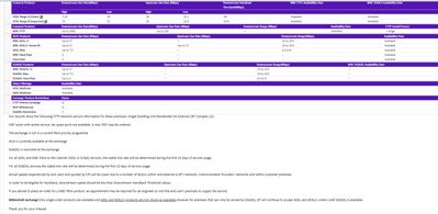

The results when using my landline number are;

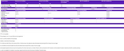

I think the results are the same, but from using my exact address on here;results2.jpg

@OryxCallotis both of those show 'ONT exists with active service' , which means that the Openreach database believes there is already an active connection, hence when you check the PN system it says no engineer is required.
Maybe you could explain what the landlord has done recently ?

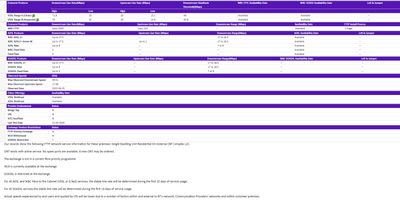

Weirdly, when I tried just the building itself, it says "FTTP is not available". I think it's just a mixup. The results messages read like;
Main Building (landlord & wi-fi for residents); "FTTP is not available".
Flat 1 (me): "ONT exists with active service. No spare ports are available. A new ONT may be ordered."
Flat 2 (neighbour): "FTTP is available and a new ONT may be ordered."
I did ask on here a few months ago because I was wondering if FTTP was worth it, and when I went to the order page it said an engineer needs to come round (I never got around to ordering it). Now after the main building got its own FTTP connection about a month ago, it's saying I already have it. So I guess the mixup started then.

Sounds like the existing landlords FTTP has been incorrectly associated with Flat 1.
I suspect its going to take some sorting out, and probably by the ISP who supply the landlords FTTP
