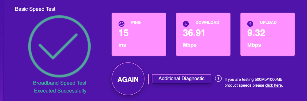

Just completed the transition to VDSL and have to say that it wasn't too bad as experiences go. The Archer VR600 connected straight away and I can confirm that the router automatically changes from listing ADSL ISPs to VDSL ISPs dependent on the connection type. I selected 'Plusnet_VDSL', inputed my username and password and away it all went.
I have added the connection and speed test results below for reference and comment if necessary but, for now, it seems to be working fine.
| Upstream | Downstream | |
| Current Rate (kbps) | 9997 | 39999 |
| Max Rate (kbps) | 22624 | 104479 |
| SNR Margin (dB) | 13.7 | 19.3 |
| Line Attenuation (dB) | 0 | 8.1 |
| Errors (pkts) | 3 | 0 |

@Phimo those connection stats show that you are easily achieving the maximum speeds on the Unlimited Fibre product i.e 40mb down and 10Mb up. The maximum estimated speeds shown by the router would suggest that should you at some point want faster speeds then upgrading to the Fibre Extra product would likely give something close to the maximum 80/20 on that also.
