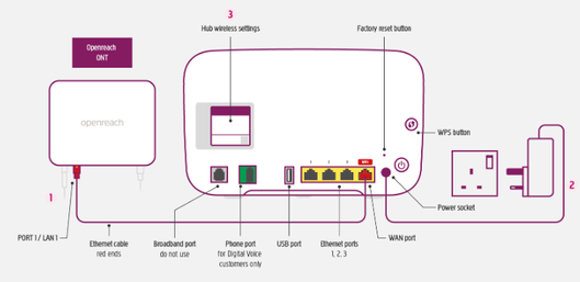

Re: FTTC to FTTP upgrade today - left with no internet
This is how the Hub should be connected
Does yours match the above?
Are you suing the correct cables, the DSL cable is now redundant and should be disconnected.
Hi yes that's how it's connected.  I'm using the red-ended ethernet cable that came with the Hub 2. And PN and the OR engineer told me the line coming in is working.  The lights on the ONT are correct.  But the status light never changes from Orange.
