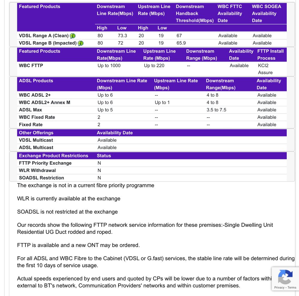

They could have a look at the following. Enter your post code only and select the address from the drop down list. FTTC shows as VDSL and FTTP shows as WBC FTTP.
https://www.broadbandchecker.btwholesale.com/#/ADSL/AddressHome

@Seneca According to that, you should be able to get FTTP from PN, although the install procedure doesn't look like the easy 1-stage.

OK, FTTC and FTTP are both available - unusual but does happen. This could be the source of PN staff confusion. You have a choice of which to go for but note that PN FTTP has no phone service and you lose any existing phone number.
If you look at the narrative you'll see the underground duct has been checked and a rope left in place to pull through the fibre cable if FTTP is ordered.
