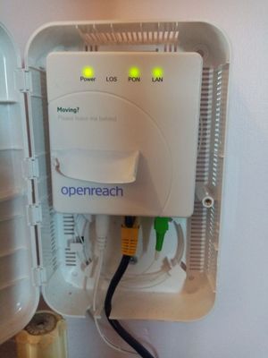

If and when they visit again you could always ask if they've got one of these in their van. Does away with the external box apparantly.

Is this what you have then?
Would be a much better option

I wish. My installation was done way back in late 2017 with a 4 port ONT and an external back up power unit.
The pictures are from a recent post by a user in NI (I believe) who had an install recently. They stated the boxes were rarer than hens teeth and were on back order.
Edit : For your information the box is attached to the old wall socket for the Master Socket. The fibre was brought in using the original cable entry and then stripped back. The splice would have been done indoors.

It is for OR to find a solution. If they don't, you won't get FTTP from any ISP who uses OR. I would copy the pictures I just posted so you have them on hand if you speak to OR in the future.

I also read this post. My interpretation of it was that it was not this 1+1 box that eliminated the need for a CSP. My assumption was that the customer had an underground duct that emerged in a recessed wall box. The installer spliced the external and internal fibres as normal but housed the splice in the recessed box rather than fitting a CSP, then fixed the 1+1 box shown on the picture over the top.

You appear to be correct. From another post by "Bella123"
Its a rural area, the existing comes underground from the pole on the roadside, under tarred drive, under the subfloor to phone socket in hallway.
However, if the installer has a box handy then it would solve the OP's installation problem.

The point I’m trying to make is that if the installer could be persuaded to install an internal CSP then there’s no need for this box.
