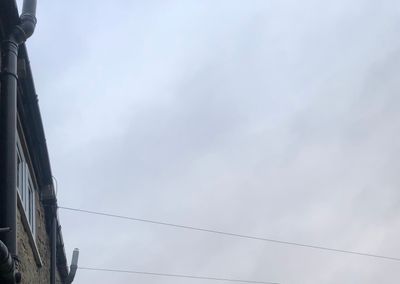

jelli
Posts: 18
Thanks: 12
Registered: ‎13-02-2025
Re: Engineer says installation will be a 'massive job'
Hi, thanks for your message. The neighbour doesn't have one of those. The pole is out of sight as you can see from the photo  and I guess the line can't go around corners Smiley
IMG_2803~2.jpg Smiley
