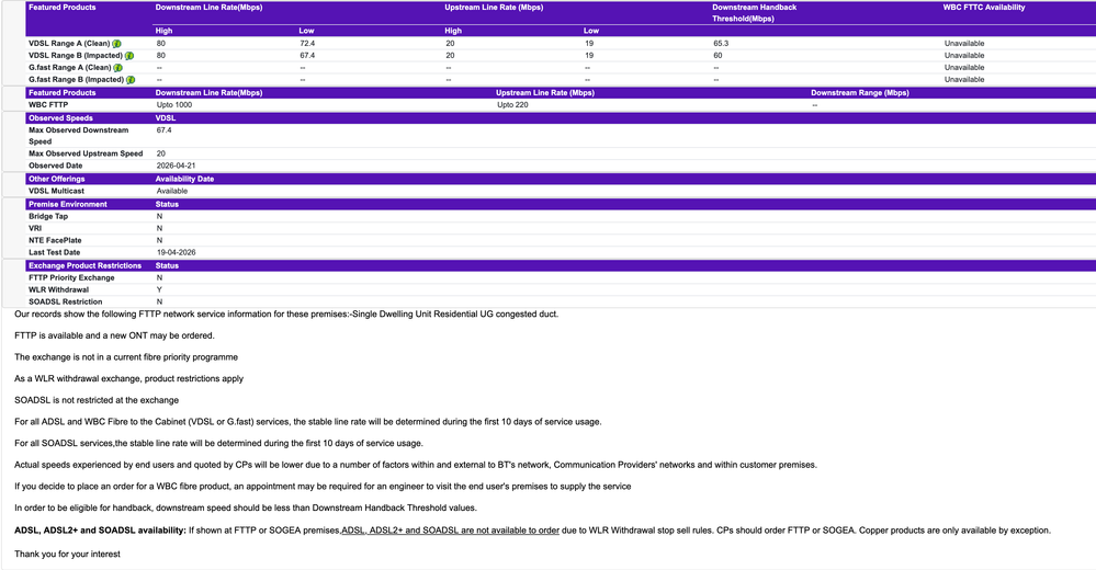

@bazzer
Look at the following
Where it says WBC FTTP what does it say to the right?
Below the results window will be a narrative on FTTP - what does this say?

Re: Engineer Dates
@dvorak
@bazzer
Thanks for the info. You missed out what it says to the right of WBC FTTP.
That aside, the results are showing a "congested duct" - this may be bad news, it may not. The engineer knows in advance what to expect and will try to get a rod through to pull the fibre cable. It they can't then it may involve digging.

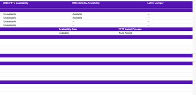

@bmc Sorry, Brian.
Here's the missing part:
