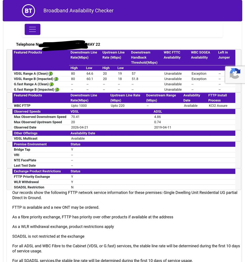

Thank you for your help, it's much appreciated.
Here is a screenshot of the results, if you're able to explain what it says in plain English I'd be very grateful 😂

This is a full fibre priority exchange so the only available Openreach option is to move to Full Fibre.. The connection is underground and there is no existing duct all the way to the property, so a new one has to be installed.
