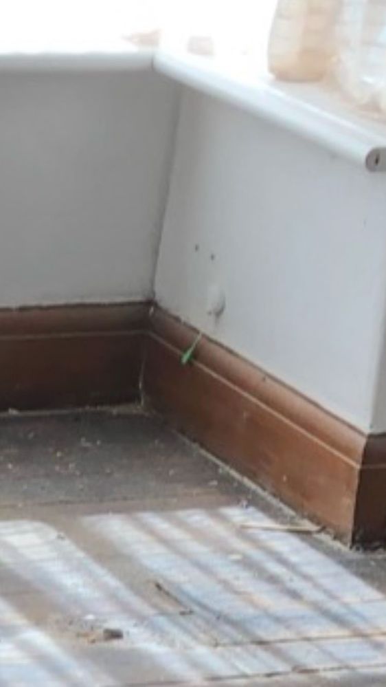

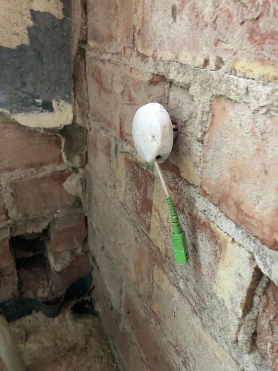

This is what he has inside when the bought the property (sorry for the poor photo):
And a better photo of how it currently is:
You can see in the first photo where the ONT was probably connected to the wall.
Most definitely no ONT regardless of what anyone's database says!
Posts: 19,462
Thanks: 8,546
Fixes: 558
Re: CSP but no ONT
@pjmarsh  well that definitely looks like there WAS an ONT. Who stripped back all the plaster ? Did they perhaps remove the ONT ? If it was your typical contractor I doubt that the fibre through to the CSP is intact.
I would think the best approach, once the plastering is done!, is to get an Openreach engineer to replace the internal fibre connection to the CSP and provide an ONT.
How one goes about that, I'll let @ClaudiaG23 decide. I suspect, as you say, the system says 'there's an existing ONT' so there's no engineer required. Having said that, there must surely be a way of overriding the ordering system and rqeuesting an engineer, but knowing how OR systems work maybe not!!
It might be the only way is to go along with the remote activation, and then when it completes, raise a fault and get an OR engineer out to check the installation.
