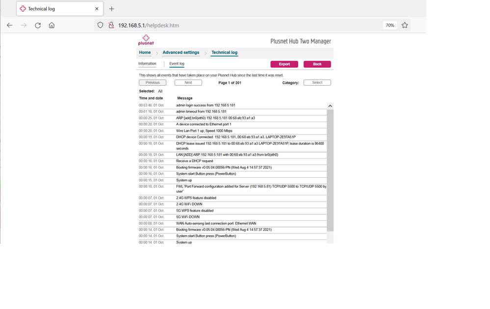

@Lshaw1 I appreciate this is frustrating, and I am not Plusnet staff or Openreach, but maybe a third pair of eyes looking at this from a different perspective could help.
I assume from your description that you are on a SOGEA FTTC service, so sight of your Technical log (see first picture) and your full Event log (see second picture), as an attachment to your reply, may help. Please edit your Technical Log screenshot to remove your identity.

Hi john please see below
Product name,Plusnet Hub Two
Serial number,+108417+2345014578
Firmware version,v0.10.00.04201-PN (Thu Apr 20 16:54:19 2023)
Board version,R01
GUI version,1.9 16_08_2022
DSL uptime,0 days 0 Hours 15 Mins 23 Secs
Data rate,10.0 Mbps / 35.0 Mbp
Maximum Data rate,15.5 Mbps / 40.3 Mbps
Noise margin,9.9/8.1
Line attenuation,12.0/20.8
Signal attenuation,12.0/28.0
VLAN id,101
Upstream error control,Off
Downstream error control,Off
Data sent / received,53.5 MB Uploaded / 2.1 GB Downloaded
Broadband username,xxxxxx
2.4 GHz wireless network name,PLUSNET-NGCFM6
2.4 GHz wireless channel,Smart (Channel1)
5 GHz wireless network name,PLUSNET-NGCFM6
5 GHz wireless channel,Smart (Channel36)
Wireless Security,WPA2 (Recommanded)
Wireless mode,Mode 1
Firewall,On
MAC address,BC:F8:7E:16:E4:10
Software variant,-
Boot loader, 0.1.7-PN (Thu Nov 30 09:45:22 2017)
Re: Broadband Intermittent -service unuseable
17-08-2024 12:49 PM - edited 17-08-2024 12:50 PM
OK. From that, there are two things that stand out to me (1) your DSL uptime is extremely short - you haven't rebooted/switched off/unplugged your router recently have you? (2) your noise margin is a little higher than it should be, with the result that your speed has dropped.
With the line attenuation you have, that engineers 'suggestion' was not the best, and in any case whatever PN support were supposed to have done in response has not achieved anything.
What would be extremely useful would be your error log - to get that, navigate to the Technical Log/Event Log screen in my second screenshot, click the 'Export' tab, and then attach it to a reply. To attach, click the paper clip icon (lower left of the reply window), and then find the .csv file that resulted from your 'Export' action.

hi John see the event log from earlier today attached
we swapped out the router for the new Router Plus Net sent to check it wasn't a hardware problem. We swapped out the router yesterday afternoon and changed the cable this morning

Thanks for that - irrespective of the fact that you have only had the new hub up for a short time, and I have only looked at about the last four hors or so, you are constantly losing DSL connection for some reason.
A couple of questions - which type of master socket do you have and is the Hub plugged directly into it? Do you have any Powerline or similar equipment installed? A picture of your wiring into the Hub and the master socket may be useful.
