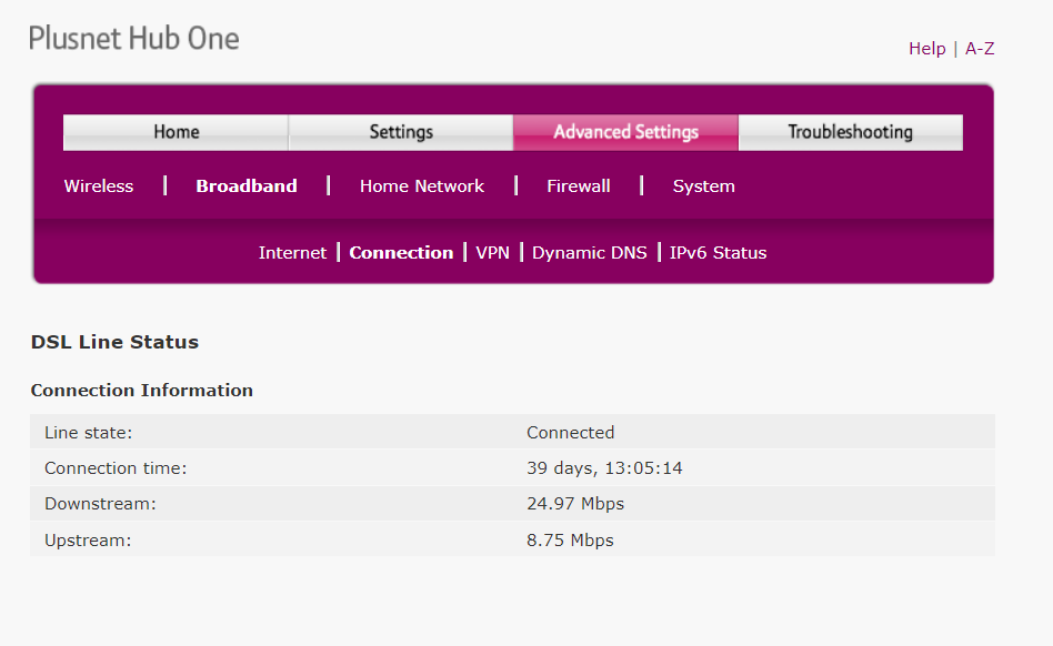

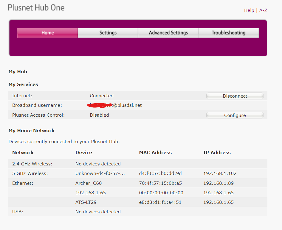

Hi, router info attached, not sure what router info is relevant.1Screenshot 2023-05-02 215707.png2Screenshot 2023-05-02 215739.png3Screenshot 2023-05-02 220031.png

@Warey Thanks for that - taking the shots in order (1) you appear to have only been connected just over 1 day, which suggest you are having xDSL disconnections - not good. (2) you appear to have been connected for 39.1/2 days, which is better - but does not correspond with (1) above - Imust be missing something @RealAleMadrid  /  @Baldrick1  / @Gandalf ?
We would be very interested in the result from the 'Troubleshooting' tab, please.

@jab1  It tells me two things.
1. There is a slow connection that, as previously stated, needs reporting as a fault. I see little advantage in considering the two secreen shots, presumably they were captured some time apart.
2. @Warey has connected another router (Archer C60) to the hub  presumably to improve wireless. Unless the Archer is connected in bridge mode then this will introduce double NATing and potentially another unrelated problem.

@jab1 Slightly off topic; from my observations.
Internet Connection Configuration >Connection Time - this is the time the broadband user has been logged in. This will be the Network uptime.
DSL Line Status >Connection Time - this is the time the Hub One first detected a cable with a DSL signal connected. This will be the System uptime.
If the Hub One detects a WAN connection then DSL Line Status is replaced with WAN Status.
So your observation is correct there was a DSL disconnect 1 day 8:52:29

@Warey
When you renew your contract ask for a Hub 2. When you get it, set that up in bridge mode and it will remove the double NAT whilst giving you the full functioality of the Archer router.
