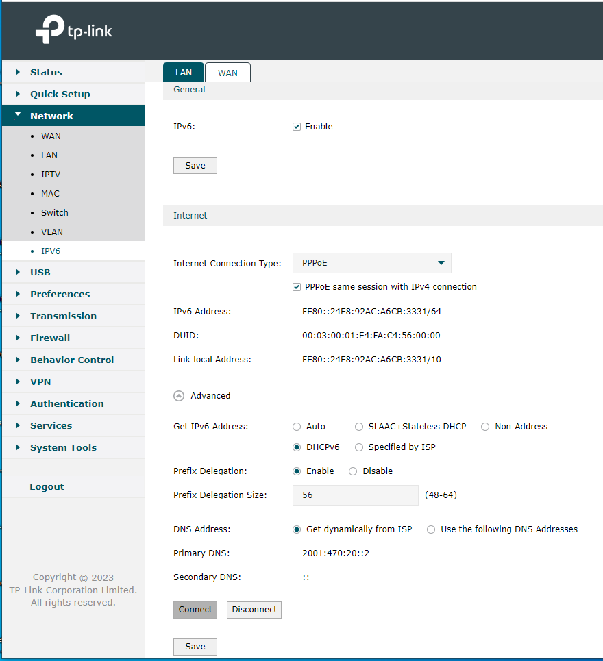

Re: IPv6 Trial Update
Here is the page from the TP Link router that doesn't seem so keen to connect

@zpeterk based on an assumption that the Tplink is almost certainly running some form of Openwrt and my experience with my native Openwrt router..
I'd suggest setting the 'Get Ipv6 addess' to DHCPv6 and the 'Prefix delegation' to Enable
Let us know if that makes a difference

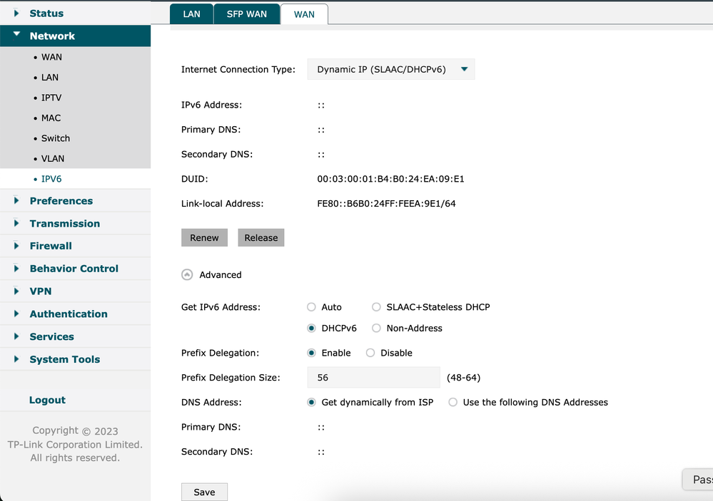

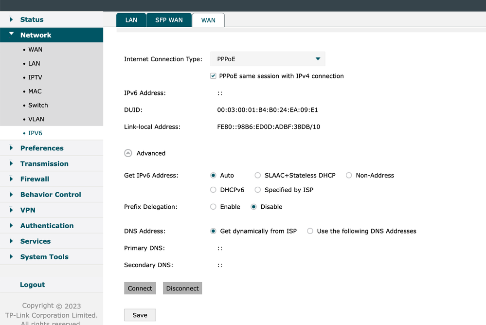

zpeterk
Posts: 469
Thanks: 24
Registered: ‎14-04-2007
Still no connection

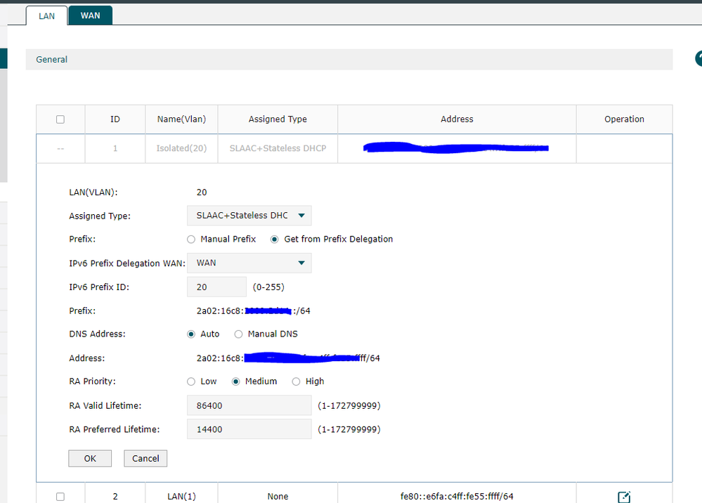

IMM
Posts: 113
Thanks: 35
Registered: ‎11-12-2023
@zpeterk These are the settings I'm using.
I don't understand why the IPv6 address seems to be a link local one but when I set up the Lan as below, I seem to have IPv6 connectivity.
I hope that helps.
Ian

@IMM
AIUI the WAN connection doesnt get an IP as such, rather it just gets a static prefix which it delegates. Your LAN looks fine and is allocating IPv6 addresses fine.

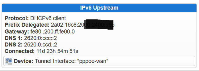

For info this is what my IPv6 WAN shows
Note, I have manually assigned the OpenDNS IPv6 DNS servers
