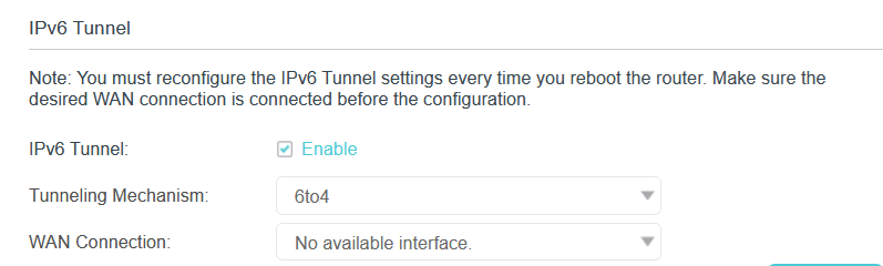

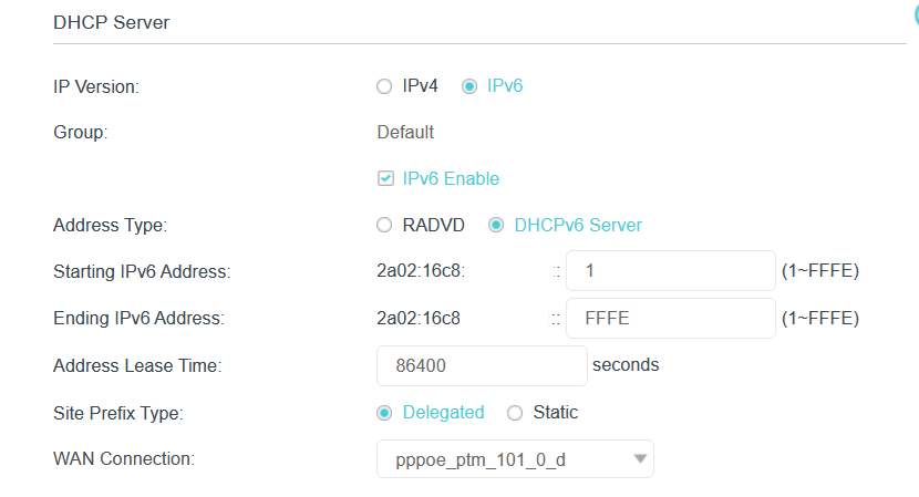

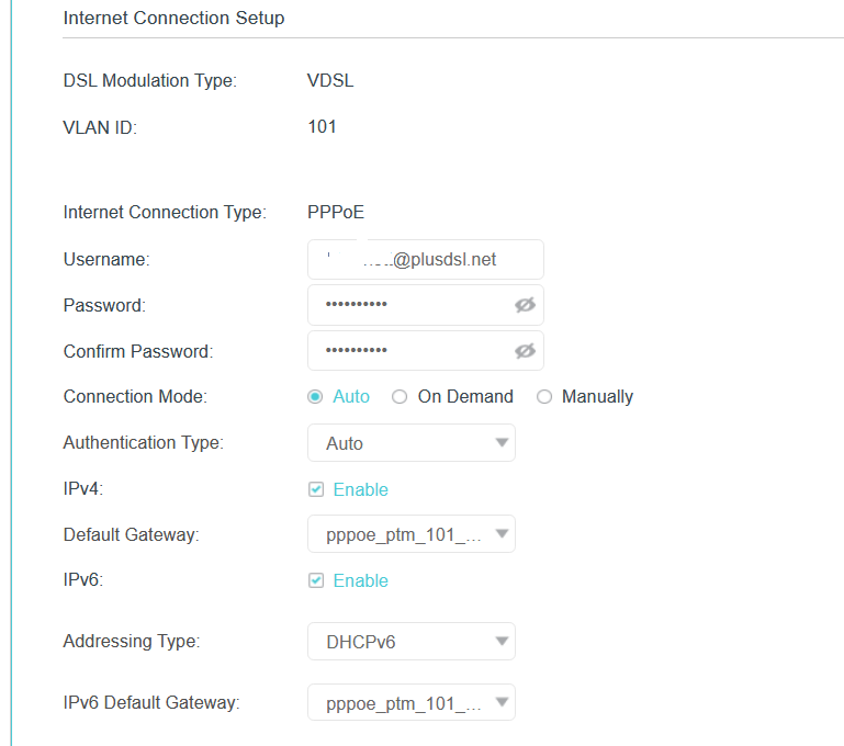

Here are screenshots of the settings in my router - I'd be grateful if anyone else with the same or similar router could cast an eye over these and compare, please.
I'm particularly unsure about the IPv6 Tunnel settings showing "No available interface" on the WAN side.

I don't see anything in the VR400 manual about prefix delegation support.
https://www.manuals.co.uk/tp-link/archer-vr400/manual?p=18
You definitely don't need the IP6 tunnel option enabled.  The plusnet trial is providing native IP6 via prefix delegation.
Not directly helpful but here's a TP Link page for some of their routers that do support prefix delegation - https://www.tp-link.com/us/support/faq/852/

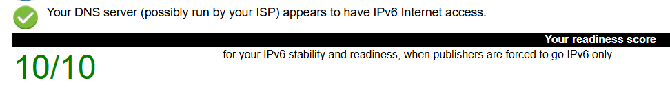

Why would Plusnet not having their own IPv6 DNS give rise to the results as is being suggested above?
Tests are agnostic of where the DNS is, so long as there is one which works.  To that point, my result is 10/10 using a Hub 2.

From post number 1 in this thread.
"The Plusnet DNS servers support IPv6 AAAA records but only run over IPv4 at the moment as such we're also assigning a he.net IPv6 DNS server address which will should mean the test above gets 10/10."
Posts: 28,979
Thanks: 13,171
Fixes: 244
Re: IPv6 Trial Update
The above quote states what the native Plusnet DNS server does AND states that a third party IPv6 DNS will also be assigned which will deliver a 10/10 score, thus challenging the claim for the 9/10 result.

Yes native Plusnet configuration with a Hub Two as will be used by the masses.
As stated in the initial post, Plusnet has put a third party IPv6 DNS into the solution stack for (at least) the time being.  Thinking this through, I imagine that there will be a need to change this at some point to support safeguarding etc.
