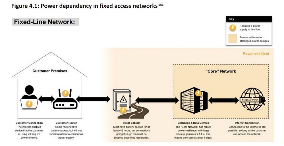

@Protech
Thanks for that.  Buried is the right word, took me 20 minutes of digging through stuff to find the relevant part!  The report that has the key info is this one: https://www.ofcom.org.uk/__data/assets/pdf_file/0034/249289/connected-nations-uk-report.pdf
This highlights the problems that those of us that live in power cut prone areas are having (from page 51 of that report onwards).  There is mention of that 4 to 6 hour cabinet backup, but the wording is "Most have battery back up for 4 to 6 hours but connections going through them will be severed once they lose power".  The implication is that not all have backup that lasts this long.  I can't find any legislation that forces Openreach to provide 4 to 6 hours of battery backup either.
Contrast the cabinet backup capability with that of the exchanges and data centres, where the same document states: "The "Core Network" has robust power-resilience, with large backup generators & fuel that means they can last over 5 days".  I find it hard to understand why the street cabinets (which are the only link between consumers and the exchanges/data centres) don't have the same back up power resilience.  A chain is only as strong as its weakest link, so consumers will lose connectivity as soon as their street cabinet runs out of power.
This is clear from the diagram in the report linked to above:
I'd like to be well-informed before doing battle with Openreach (who, in my past dealings with them when building this house proved to be absolutely the very worst company I've ever had the misfortune to deal with).  4 to 6 hours would be better than nothing, but power cuts lasting over 4 ours are not infrequent here (hence the reason we have a backup power system that can keep the house going for two or three days).  Last winter we lost power three times, and the shortest outage was about 4 hours, the other two were a lot longer than that.  We were heavily reliant on the landline phone each time this happened, both for information as to when we might expect to get power back and to reassure friends and family that we were OK.
