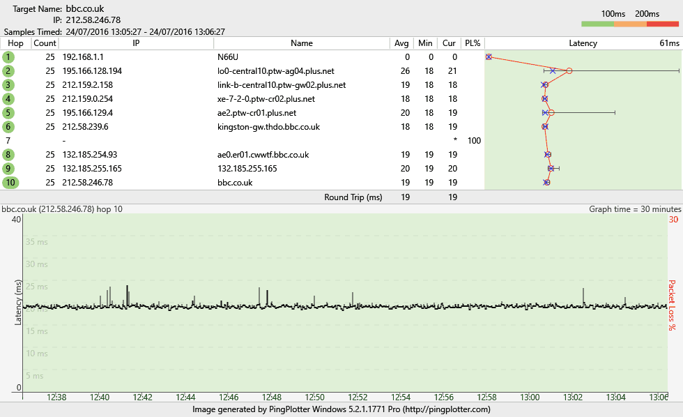

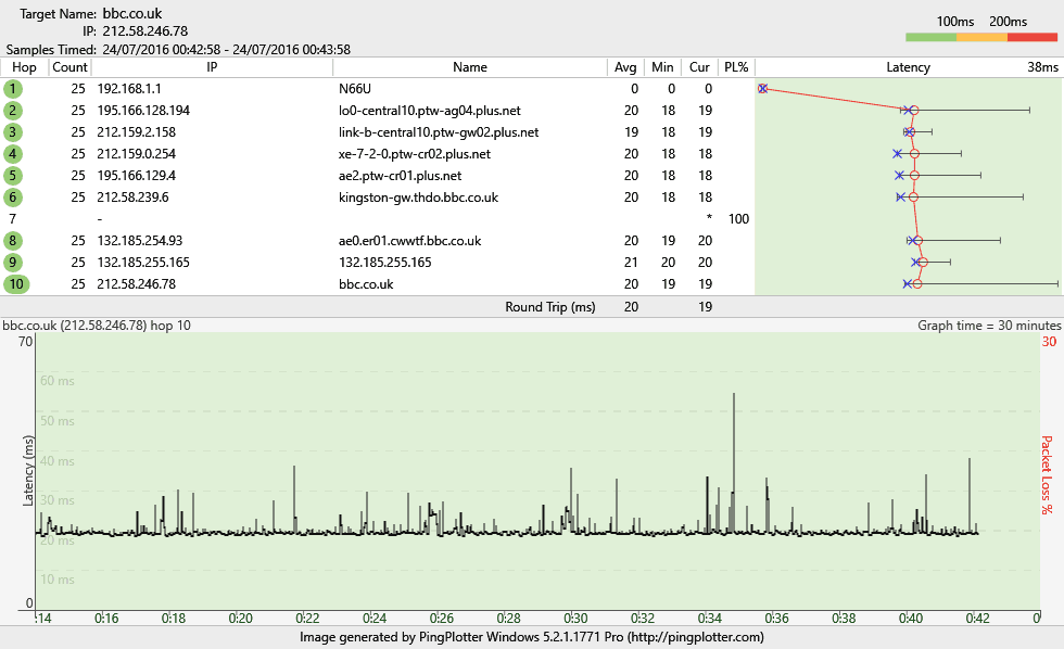

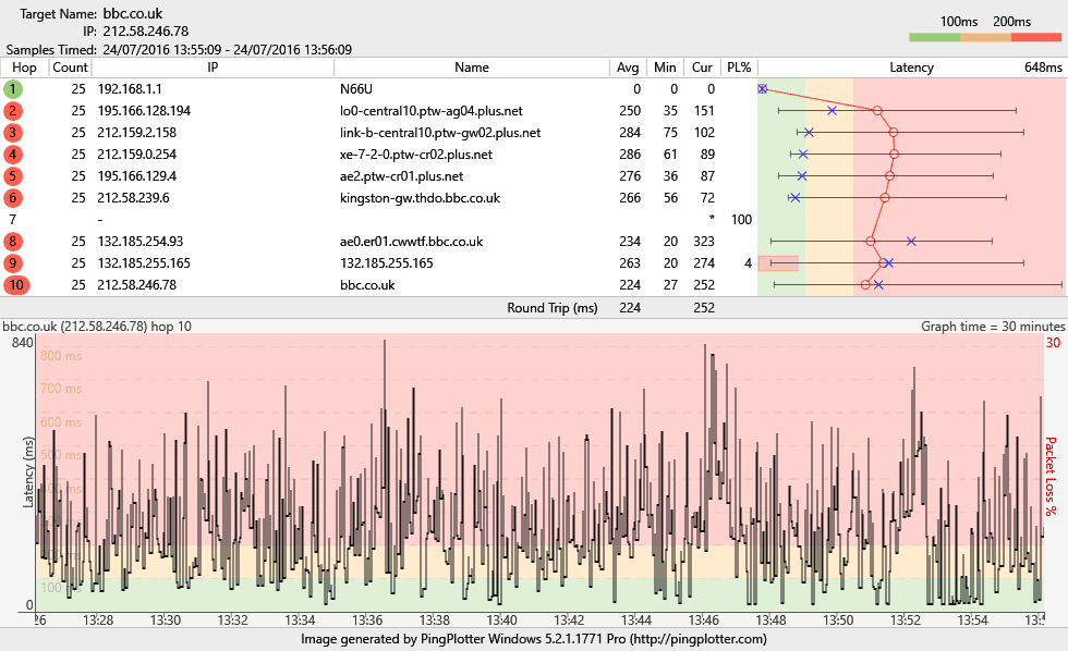

markb5000
Posts: 73
Thanks: 4
Registered: ‎13-10-2015
Re: Gaming Issues Latency/Ping
So its several weeks later and i apologise for not posting back sooner but this is still a major issue for me. BO3:COD Zombies is unplayable as i am constantly rubber banding with the ingame ping monitor jumping up and down.
Since i last posted i have checked Wireshark classification and the majority of games are being classified correctly. The only game i found to be classed wrong is "War Thunder" as its being classed as 0x00. I tried to open a ticket regarding this as suggested in the forum but couldnt find the appropriate topic.
Besides that i have been monitoring my ping response times and how they vary with different traffic and rates. I found using an FTP server with Filezilla was easiest for this as i could influence the download and upload rates by setting the speed caps.
What i found is at idle zero load my pings are nice and stable 21-24ms but as soon as i allow any traffic, even as small as 100kbits my pings start to spike and can be anywhere around 21-500ms.
I have attached a screenshot of my results for reference. You can clearly see i have limited to my line to roughly 40% saturation yet the pings are crazy high and jittery. This amount of jitter is for sure the cause of my problems and explains why i am unable to game.
Could this be a potential line problem or issue at my exchange? Idle is fine but any amount of traffic however small and the pings go crazy. I could understand it if i was saturating my line at 100% but clearly i am not and even then should plusnets qos not come into action?
nanotm
Posts: 5,756
Thanks: 156
Fixes: 2
Registered: ‎11-02-2013
its been a few years since I did wave propagation and line transmission theory but is it possible your line is old and degraded causing the fault ?
it sounds like the problem is "interactive" in that data transmitted up/down creates the fault condition (packet loss) a problem that interleaving is designed to fix, possibly having it switched on would fix the problem although it would likely push your standard ping times up to around 45ms (still well below the threshold for problems)
you can always ask for it and if it makes things worse then go back to fast path, another option would be to flush the cache and route tables on your devices (including the router) to force it to find new routes, might be an option to run a tracert to the game servers and see what hops your data is taking (maybe one of them is at fault) but realistically you would expect everyone else to suffer the same problems if that were the case.
it was problems like that that drove my initial move to fibre a few years back because my line had constant problems (when I was with BT the fella they sent out said it needed replacing but the company wouldn't fund that)
just because your paranoid doesn't mean they aren't out to get you

Its a possibility yes as the line beyond my property is likely from the 80s or 90s, it certainly hasnt been updated in a long time. Saying that, a section of the line was replaced when i first called openreach out 2 years ago due to it causing noise on my line- replacing it fixed my noisy line but the latency has always been a problem so the line being old and degraded is a strong possibility here.
I have had interleaving on and off over the years with no change to stability. My stability actually got worse last time i had interleaving on and i had to ask PN to put me on fast path again.
As for the trace i have checked routes to various sites and games and other than the fluctuating ping they look fine. No packet loss or anything out of the norm going on and a perfect route from what i can see. Sure 2 middle hops are timing out but the final hop is fine.
tracert bbc.co.uk
Tracing route to bbc.co.uk [212.58.244.23]
over a maximum of 30 hops:
1 <1 ms <1 ms <1 ms N66U [192.168.1.1]
2 19 ms 18 ms 19 ms lo0-central10.ptw-ag04.plus.net [195.166.128.194]
3 19 ms 19 ms 18 ms link-a-central10.ptw-gw01.plus.net [212.159.2.156]
4 19 ms 18 ms 18 ms xe-7-2-0.ptw-cr01.plus.net [212.159.0.252]
5 19 ms 18 ms 18 ms kingston-gw.thdo.bbc.co.uk [212.58.239.6]
6 * * * Request timed out.
7 * * * Request timed out.
8 20 ms 22 ms 19 ms ae0.er02.telhc.bbc.co.uk [132.185.254.105]
9 22 ms 20 ms 21 ms 132.185.255.148
10 19 ms 18 ms 18 ms 212.58.244.23
Trace complete.
Even at idle though i dont really consider it stable because its constantly going up and down from 20-25ms and occassionally spiking. From my experience with previous lines a good performing line should rarely move from 20ms and at most should only show 1ms of jitter at idle.
I cant say whats supposed to happen when at full throttle as its something i've never looked at before but this is what i am getting with the connection maxed.
I expect it will be very difficult to get openreach to do anything about it as all they care about is whether you are getting sufficient speeds but i've honestly just had enough of the poor service and its looking like fibre will be a long time off for me so really hoping i can get this fixed.
