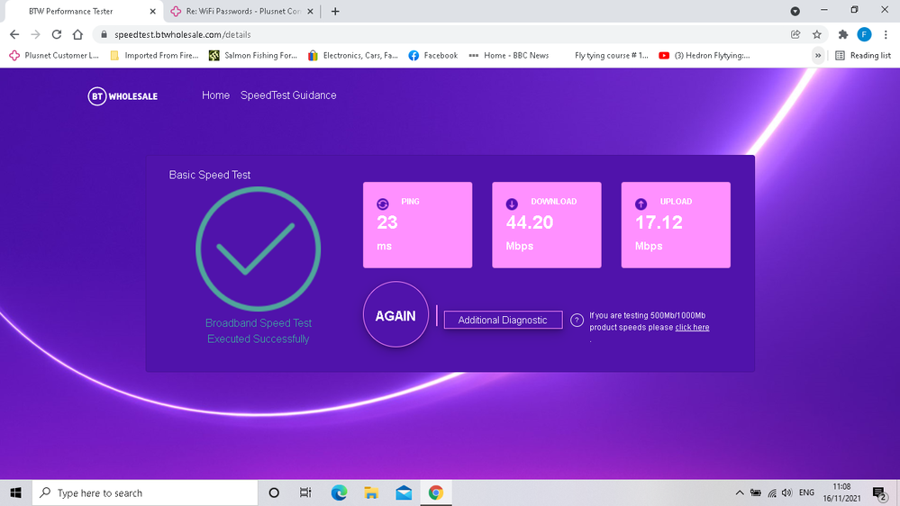

When i first got the Hub i was able to connect to the 5ghz with laptop and other devices, Ookla speedtest on 5ghz channel was almost 70mbs. Now stuck on the 2.4ghz channel just over 40mbs, that's a big difference.Screenshot (1).pngScreenshot (2).png

Re: WiFi Passwords
Don't doubt you, but I have considerably higher-specced modem/router and am running two laptops - one is only 2.4Ghz, the other 5, and they both report near-identical figures, to within .2Mbps of each other.
