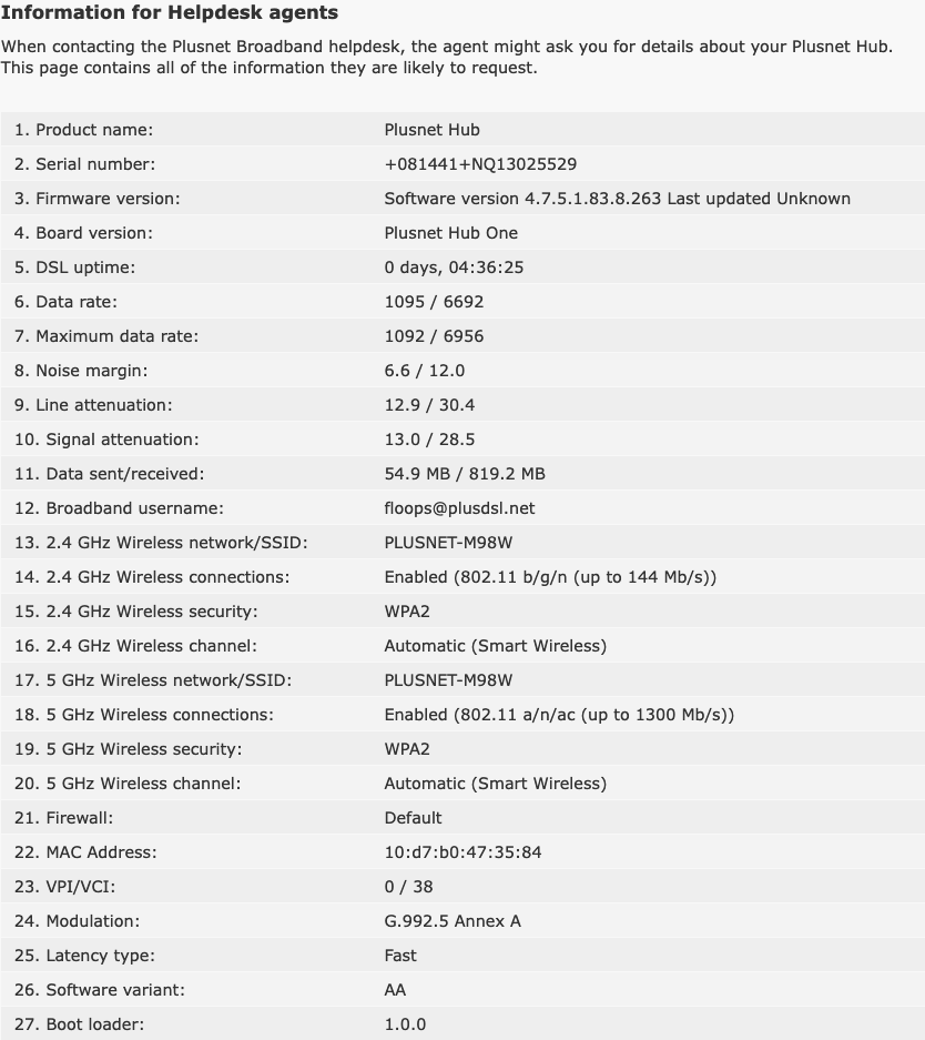

OK. Can you post the 'Help desk' tab from your router please, obscuring any personal details? the picture below should help you find the information requested.
Re: Upgraded to Unlimited Fibre speed unchanged.
04-11-2021 9:05 PM
04-11-2021 9:07 PM
04-11-2021 9:11 PM
According to that, you are still connected on ADSL, and as an aside, your downstream SNR margin is very high.
