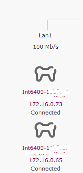

So, did you ever reset your PLA's to run on the PNH1 default ip range or could they be on the Talk Talk ip address range - they should work not matter what, but they can sometimes 'hide' themselves on the hubs home network page. I still can't understand why they worked well for years and suddenly went wrong.
You'll see them (if the hub sees them) on this page - http://192.168.1.254/index.cgi?active_page=9133 (once you type in your hubs password that page will refresh a few times)
Having said that, we now use the hubs other ip range of 172.16.0.1 (for the UI) and the DHCP range of 172.16.0.64 - 172.16.255.254. Again powercycling the PLA's helped them move to the second ip range available.
The hub will show them as gaming controllers!!
