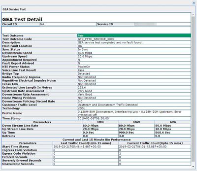

Here you go:-
Interesting that an availability check here suggests that the bridge tap condition was not being detected back on the 12th.
That said, your connection remains stable, you are synchronising at headline speeds, and there are few errors reported on the line.
There's nothing to say this is the case, but it's worth north noting that a bridge tap can be detected as the result of issues with your internal wiring/cabling.

Cheers Bob I appreciate the efforts. And thanks for providing the results in full. I'm disappointed that the Bridge tap remains after being told yesterday that it didn't, and even receiving partial kbd details to back this up.
