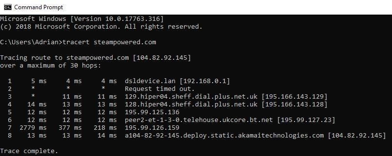

I know it does effect my internet connection because these spikes occur when pinging other sites and not just the local gateway as shown in the screen shot attached. The lux.valve.net is one of the game servers that I play on which is EU West.EU West game server
Steampowered.com

Whenever I do a tracing route test the 2nd hop always results in "request timed out" no matter what site I am tracing. From what I have heard, this means that the gateway does not respond to ICMP, meaning a firewall must be preventing it from doing so. I am not sure if this is a problem or not.
That's expected behaviour.
