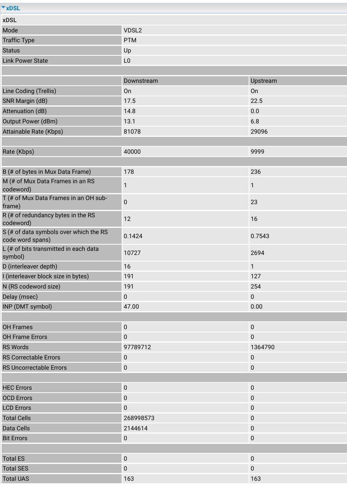

What the hell going on as they now making it lots worse as the sync rate drop from 81/29 to just 45/16 - can't believe this. What the hell going on? Fuming with Openreach Engineer went to the same joint box thinking it broadband fault (that's nothing to do with broadband fault - it a phone fault with local network. This mean we can't upgrade faster fibre extra 80/20 next time as the speed isn't maximum anymore. Not happy at all. I know it 40/10 service but they shouldn't mess it up with max line rate 81/29 to 45/16 as it might end up broadband losses and reduced speed again like last time in this link: https://community.plus.net/t5/Fibre-Broadband/Incorrect-plusnet-line-speed/td-p/1804180
The engineer should leave broadband fault alone!!!! Nothing wrong with it it been rock stable. FED UP now. Why 45/16??? So, we can't upgrade 80/20 in the future.

I want another GEA Test again please!
before engineer sync 81/29before engineer sync 81/29after engineer 45/16after engineer 45/16

I was talk about the data max rate 81/29 down to 45/16 as I am aware we are on 40/10 product. The BTw checker will soon changed from 80/20 on VDSL Range A 80/20 to 45/16 then we can't upgrade to Fibre 80/20 because the data max rate is no longer 81/29 on FTTC sync from the cabinet to the router. As for the phone line, there never been any noisey on the line as broadband was rock solid for a long while without issues as I don't understand why Plusnet failed voice call all the times?
Nothing wrong with our line. Disappointed to see the data max rate 81/29 has gone!

Thanks a lot for your response. The line looks fine to be honest, and in theory, the data rate on your Helpdesk page should have never been exceeding 40Mbps, as this is the speed that your line is being capped at - based on your product. The maximum data rate is different though, and alludes to the maximum speeds that your line could achieve regardless of the product. On BT's side at the moment, this is still 80Mbps.
Something to note as well, if it dips below 80Mbps., this won't stop you upgrading to Unlimited Fibre Extra. My KDB this morning - which I'll pop below, also shows that the phone fault has now been resolved as well, and an RRT shows that the line is performing fine. Smiley

I have told my parents not worth it to upgrade to 80/20 because the attainable rate (Kbps) has now reduced to 45/16 so if they did upgraded to 80/20 it only put their line on 45/16 (then DLM will try target 3dB to get the line up to around 50Meg or less) an extra 10Meg isn't worth it in my view.
They don't need faster 80/20 anyway as 40/10 are fine for you tube on tv, checking email and internet on their mobile.
I was very amused and surprised the attainable rate changed from 81/29 to 45/16 with swapping the line port over and the line attenuation has increase large to reduced attainable rate!
