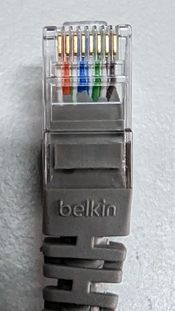

If you look at the ends of the cable you should see 8 wires
Is this the case, can you try another cable to prove the current cable is not the problem?
