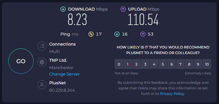

Speedtest.net

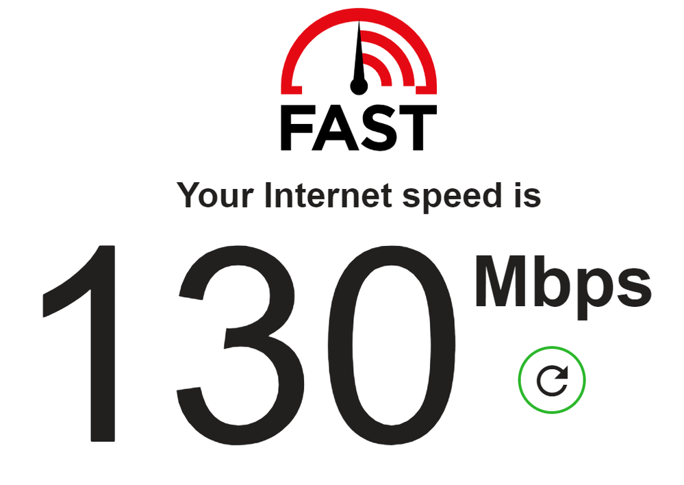

Fast.com

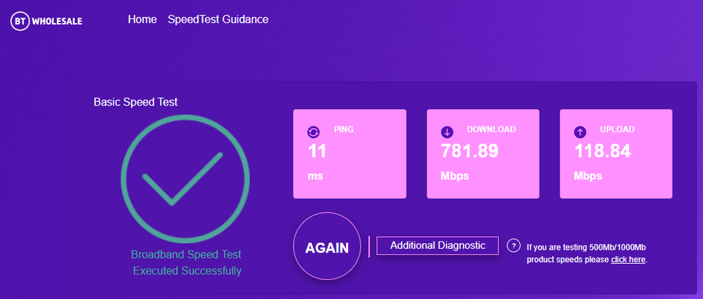

BT Wholesale

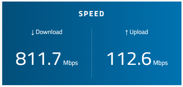

Waveform
