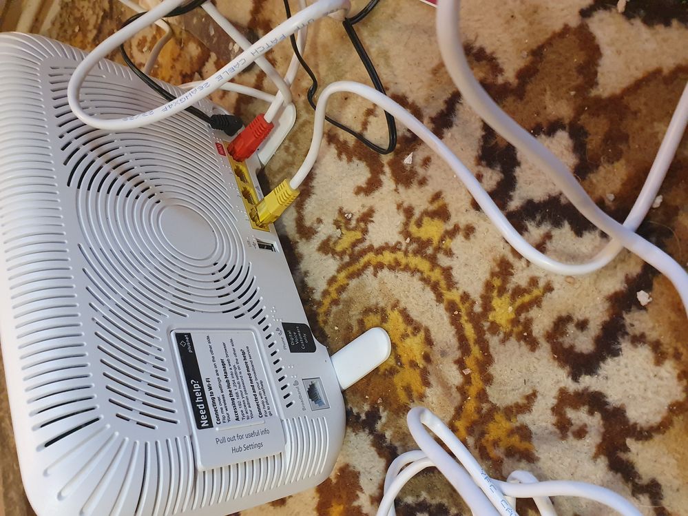

Just so we all have a better picture, can you send in pictures of where the router is located etc and how it is set up? I can't test sync speed on full fibre you see. I know the guys are also going to ask to see the router stats so are you able to log into the router and give us the stats from there?
"Advanced Settings" > "Technical Log" > "Information" page of the router.

router setup was done by BT please see attached photographs.
Please see below the router information20231219_124112.jpg20231219_124912.jpg bit you asked for.

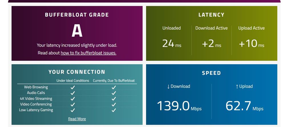

tell me about it. please see photo of the wired speed test carried out. 20231219_125220.jpg

@Nr352pa112 thanks for that, at least it shows the cable from the router to the ONT is correct and is a gigabit link
Data rate:1000 Mbps / 1000 Mbps
The stats dont show the uptime for the router ? roughly how long is it since you last reset it ?
Is there any possibility that there is a device connected wirelessly that is downloading a lot of data ?
or possibly the laptop trying to download updates whilst doing the speed tests ?

Might speedtest cli be better to use here?
Re: Slow Download , high upload, high ping
@Nr352pa112  do you get similar results using a different speed tester ? - such as Waveform Internet Speed Test
On my connection have never found the BT Wholesale "Performance Test" to be anywhere near accurate !

Its a work laptop. local government issued . so alot of restrictions etc (no downlaoding apps, cannot run CMD prompt etc)
@Nr352pa112  Aah! My guess that its almost certainly running VPN software and so any internet access (including the speed test) will be via the VPN.  That may well be throttling the speed...

@Nr352pa112 you could confirm if a VPN is active by going to https://www.whatismyip.com/ in a browser and comparing the IP shown with the one shown on the router status page. If a VPN is active , they will be different
Probably not useful now if the VPN is the problem but as @Dan_the_Van said earlier the Ookla speedtest cli (https://www.speedtest.net/apps) is the most consistent test for higher speeds. Problem is you're probably not allowed to install it! The browserbased one is https://www.speedtest.net/
