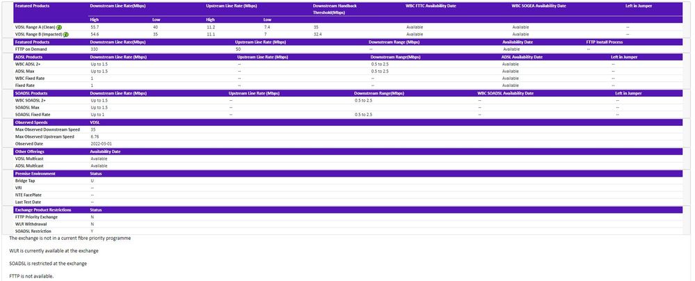

@BO55 No doubt one of the Help Team will get to this, but it would be interesting to see the results of: BT Broadband (obscuring your phone number), BTW Performance Tester , and the Help Desk page of your Hub - if you are using the supplied PN Hub.

Re: No improvement
Posts: 25,208
Thanks: 9,114
Fixes: 387
Re: No improvement
@BO55 With such a low max available speed, I would go for the cheaper package. The other two screenshots would still be useful, though.

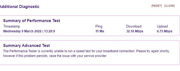

Thanks for that info, @BO55 If you are only 480m from the cab, those speeds are atrocious. Sorry to be a pain, but can you post the 'Advanced Diagnostics' from the BTW speed test page - it would give more information. Also- looking at the details you have provided, it looks suspiciously like you are provisioned on 'Fibre' and NOT 'Fibre Extra'.

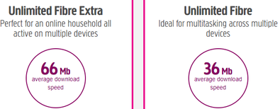

@BO55 The 66Mb package you refer to is the average speed customer can get expect with Unlimited Fibre Extra, not the actual expected speed, for Unlimited Fibre the average speed will be 36Mb.

No problem, @Dan_the_Van - but with the BTw checker only offering 55mb/s as a max to the OP, I see no benefit in paying for the higher package. Good spot re: the static IP - I can never remember the best way to spot that.

@jab1 totally agree no need paying for something you'll never achieve.

@jab1 I did run the advanced test this morning but it won't let me again .....Summary.JPG
