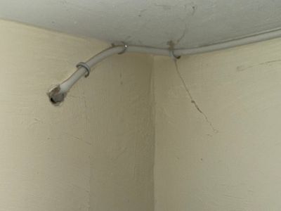

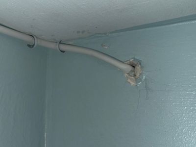

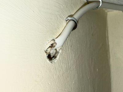

i do have a reasonably sharp … turn? bend? I wouldn’t call it kink… in my fibre. Internally it runs along the ceiling and as it enters the room through the wall it comes out to the drill hole and back and it’s pulled so tight…
I thought if that was too much it just wouldn’t work…
I could take a picture if it could be relevant.

I can attach a photo of the cable but it’s probably fine at a 90° bend it has. I can attach some CSV output from yesterday if needed.
Its not so much the extent of the bend as the bend radius that's significant. IIRC 30mm is the recommended minimum bend radius. (about a £2 coin). I'm no fibre optic expert either but If the fibre has been bent too sharp and damaged, would temperature changes cause intermittent problems ?
A photo would be useful.

Photos; I ran down to take a couple quickly; I hope they're clear enough. I'll don't think it's too too bendy but it seems a little bit tighter than what was suggested. Sorry for cobwebs...

@iZian well to me, from that 1st photo showing the cable entering the hole, I would say that bend radius is considerably less than 30mm! . What do you think @Dan_the_Van @markhawkin ?
Also , that doesnt look like normal internal fibre ?? Internal fibre from the CSP to the ONT is normally only around 3mm diameter. That looks more like cat5 ?
Who fitted the cable ? I didnt think Openreach (or their contractors) would fit fibre through walls ?

@MisterW it's definitely fibre; I saw him stripping the black "outdoors" protection off it when installing. I live a mid terrace and there's no where really at the front where this could have gone, it's a terrible house, so we had to take it up a floor, and through the landing to where the small room is where the phone line was and all the router and hue bridge and the old landline base station was all in there.
Outside it has its black coat on. Inside it's this white cable that runs to the ONT and has a green end to it plugged in next to the power and the cat5e cable that runs to the hub 2.
Outside it runs down to the grey box at the front of the house and that's it. I'm 100% sure it's the fibre, when installing he wanted me to check it was not "kinking" as it was being pulled through.
Perhaps there's a thicker protection on it now? I heard that delicate fibre cables were a top cause of pain with people moving furniture or pets etc before.
I only have a tape measure but the cable looks to be about 4mm thick... I zoomed in a lot...
You could be right, its a few years since my fibre was installed and the ONT is directly opposite the external CSP , so I only have a loop of 10cm or so of internal fibre to the ONT.
Just reading https://www.openreach.com/content/dam/openreach/openreach-dam-files/new-dam-(not-in-use-yet)/documen... and the pictures do show what appears to be thicker internal fibre, and the EZbend stuff does seem to be more tolerant of bends.
So maybe the possiblity of a fibre problem is a red-herring. However It might be worth some gentle pressure around the obvious bends just to see if that precipitates any packet loss.
