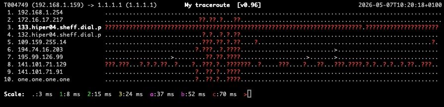

Regarding MTR; I have one set up for cloud flare; but it reports 99% loss at the 2nd hop 133.hiper04.sheff.dial.plus.net.uk which I think doesn't help much because that's when my pings to cloud flare are going through fine... so that sounds like that hop just doesn't like responding to pings. But I get a different route on traceroute to mtr. in fact I get a different route every single time I traceroute or mtr
Edit: I will keep the MTR going and look to see if any other hops also go red if I have a packet loss burst

@Dan_the_Van it didn't take long; the first packet loss burst with mtr running showed every hop was lost from the first one to the last.
And like always it's about 10 seconds each time. I think sometimes it's as low as 6 or as high as 14 or so... but I don't think I've see less. I don't think I've seen more. Enough to knock out the video meet. Or the phone call because I have wifi calling
