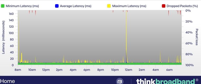

So it’s looking like this from this morning. It almost feels like this is “when someone else is doing something”. Ignoring the midnight spike when all our backups run I’d expect maybe a bit of something then.
or maybe the ONT isn’t happy.
Either way I’m just lost as to what I can do. This affects my phone calls unless I turn off WiFi, it affects my work…
