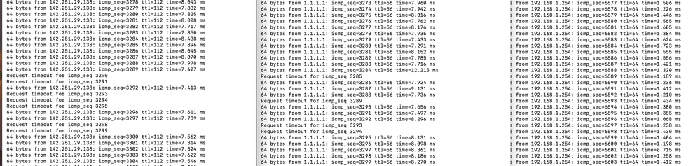

first drop out since Ethernet testing
all devices lost packets to google and cloudflare for about 10 seconds. No internal pings to router was lost.
screenshot is from the Ethernet connected device. The WiFi device showed near identical dropout to both external IP.
Virgin use their own fibre so wouldn’t be using openreach. There’s something beyond my routers before cloudflare that’s dropping packets. The ONT. the aggregator or PON or whatever it is. Or Plusnet. But I never had this issue with FTTC
the pings are just the test. The actual issue is my video calls drop out both up and down. Not just one but both directions. I lose them and they lose me.

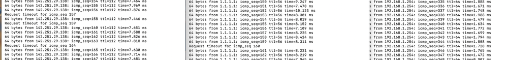

second instance this afternoon; same result on ethernet again
pings at 2 second intervals 10-15 seconds of loss. Internal pings at 1 second
