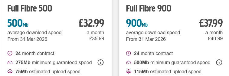

Re: New Customer
@bmc  this ?

Because the upload is 110, this shows the profile is right, so no idea whats going a miss.
@phoenix1605 normally you are correct but I've seen instances where OR manage to get the downstream profile incorrect and the upstream correct.
There is no settling period for FTTP so its not going to improve in time.
I'd suggest just checking with other speed testing sites (including the BTw one - if its working!) and if they all show the same then report a fault. Don't let them fob you off with 'its in the settling period'.
