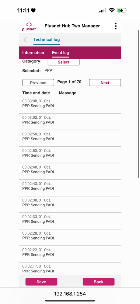

IMG_0281.pngThank you. Ok here is the page I get in advanced settings.
Posts: 5,000
Thanks: 3,307
Re: My router has broken
@MatthewWheeler
PPP Sending PADI (PPPoE Active Discovery Initiation)
Is there an outage somewhere the Hub two is unable to make a PPPoE connection.
I doubt a replacement router will fix this issue
EDIT: the retries are every 5 seconds, these would result in the ONT LAN led to flicker as the same interval
