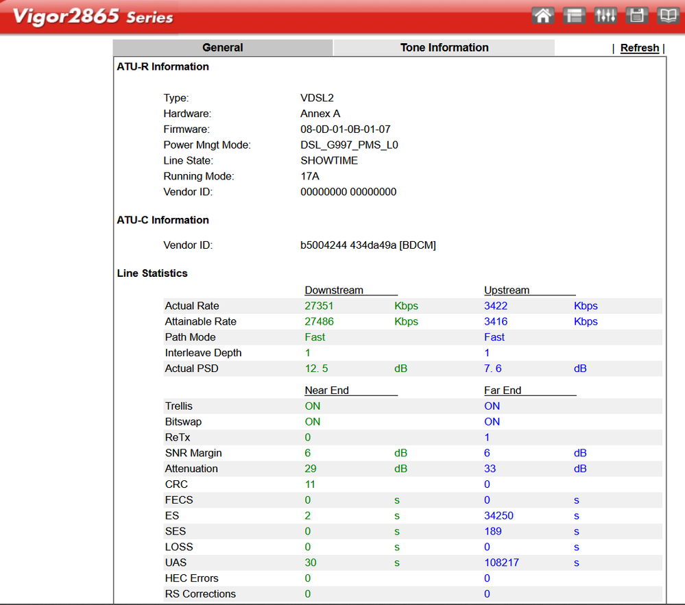

milvusmilvus
Posts: 26
Registered: ‎25-04-2019
Re: Large difference between Attainable Rate and Actual Rate. IP Profile stuck ?
Looks like the banding has been removed, the line is doing learning resets every few hours now. SNR is at 6dB as well.

LaurenB
Posts: 2,577
Fixes: 131
Registered: ‎07-12-2017
Hiya @milvusmilvus, thanks for getting back to us. I am pleased the banding has been lifted.
There was quite a few drops over the course of yesterday so may be worth monitoring things over today and if the drops persist, we can look to amend your profile from standard to stable, which will try to help and improve stability.
