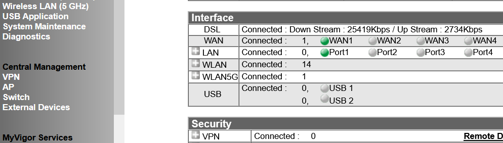

I used to get well over 20Mb but the last few months its been down to 17 or so.
My Router shows the attainable rate to be well in excess of what i actually get.
When i signed up the speed was OK but its very close to minimum Guaranteed Speed now.
Is My IP Profile stuck or should it change automatically ?
I only have one Master Socket and the Router is plugged in to that.
Thanks...
Initial speeds.....
Current Router Speeds......

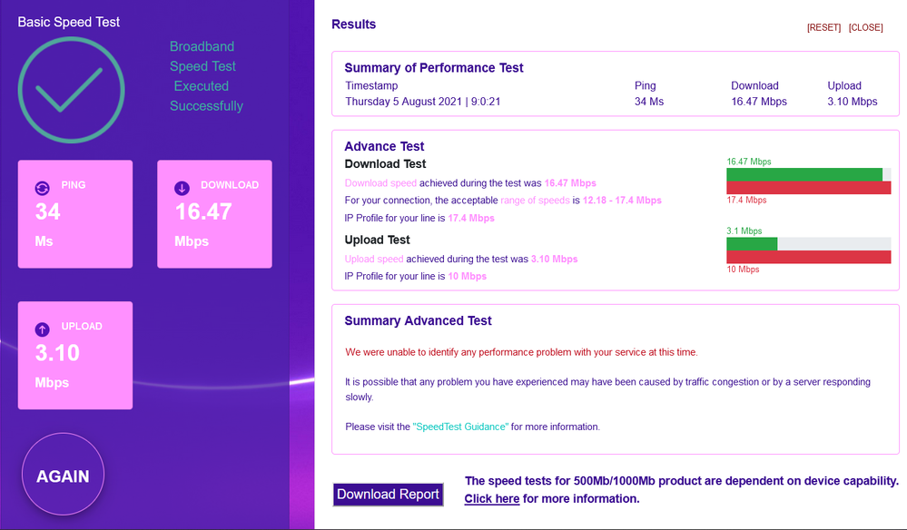

Test by PC...

@milvusmilvus  From the modem stats it looks like your downstream is banded at 18Mbps, that is capped at that speed. The fact than the downstream SNRM is much higher than the usual 6dB is evidence of the banding. You need  Plusnet to do a GEA test on the line to confirm this. They can then request a DLM reset to remove the banding.

Thanks a lot for reaching out here and apologies for any inconvenience caused by this. You're right, the line can achieve higher speeds, up to 29.1 Mbps according to a more updated BT Availability Tracker. Definitely looks like the speeds have been banded here.

After my report of slow speeds Customer Service have come back with
“ I have tested the line and found no faults. The line is stable and running at a speed of 18mbps.”
I knew that and that’s not the issue so will your reset request still go ahead ?

It seemed to fix the problem, but more recently the speeds have been reducing and i think they have done it again.
Its stuck at 16Mb now.
Can anyone help me once more to lift the restriction ?
