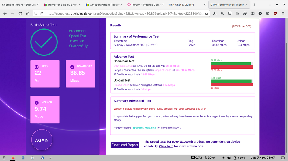

Posts: 25,446
Thanks: 9,244
Fixes: 389
Re: IP Profile reset request
I know I'm not a PN customer, and my route to the BT tester will be totally different, but my result below is in line, consistently, with the below screenshot.
