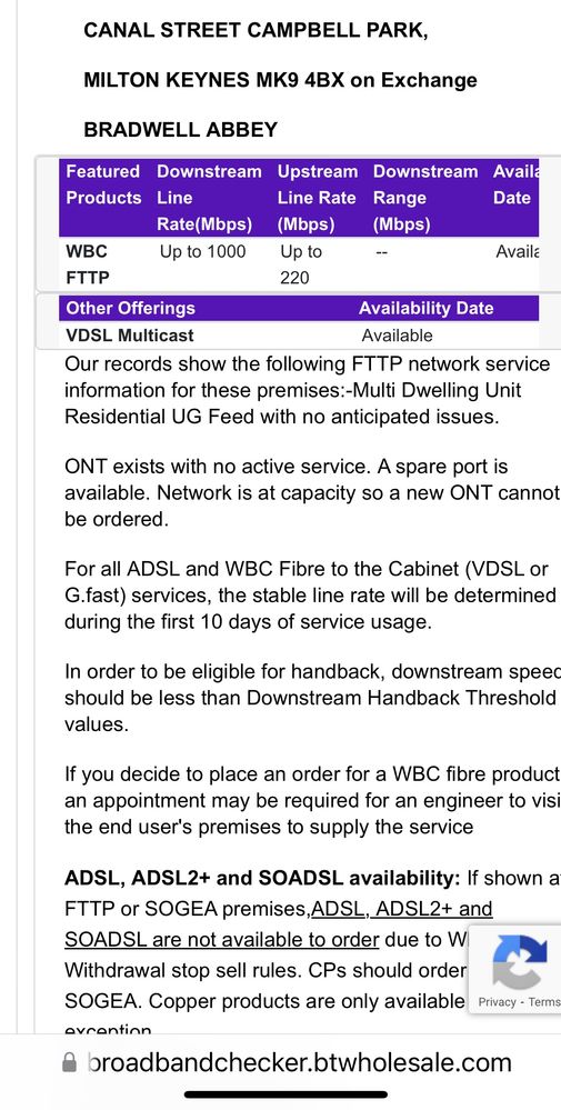

Hi. Yes this is what it states for his specific flat. Does that mean there's an ONT somewhere in the flat and it would be available for a supplier to enableIMG_1861 (1).png?

Thanks for the screen image.
Yes, the ONT will look like the pictures.
Given the cable has already been run to the flat and OR think there's an ONT the only question now is capacity.
Is you son starting a new PN account or moving an existing service?
Either way I would suggest phoning PN sales and ask them about whether an order can be placed or not.

As @bmc said earlier , it looks like the building was kitted out for FTTP during the build.
To summarise, the BT wholesale checker says there's an existing ONT, so Plusnet will be able to place an order. It should be able to be placed as a remote activation and so will only take a couple of days to activate. It might take slightly longer to get the router delivered but it shouldn't!.
There's two possibilities as to the actual installation:-
1) The ONT is located in a common communications area and an ethernet cable as been installed to the flat, terminating in an RJ45 faceplate, into which you connect the router.
2) The ONT is hidden somewhere in the flat in a utility cupboard and (maybe) there's an ethernet cable to a more conveniently located socket as above.
In the case of 2), make sure the ONT remains powered after you place the order. Openreach will do an automated test to check the ONT is functional, if it fails , the order will revert to requiring an engineer visit and will take around 10 days. I would assume if its 1) above the the ONT is powered from common building supplies and should always be powered.
