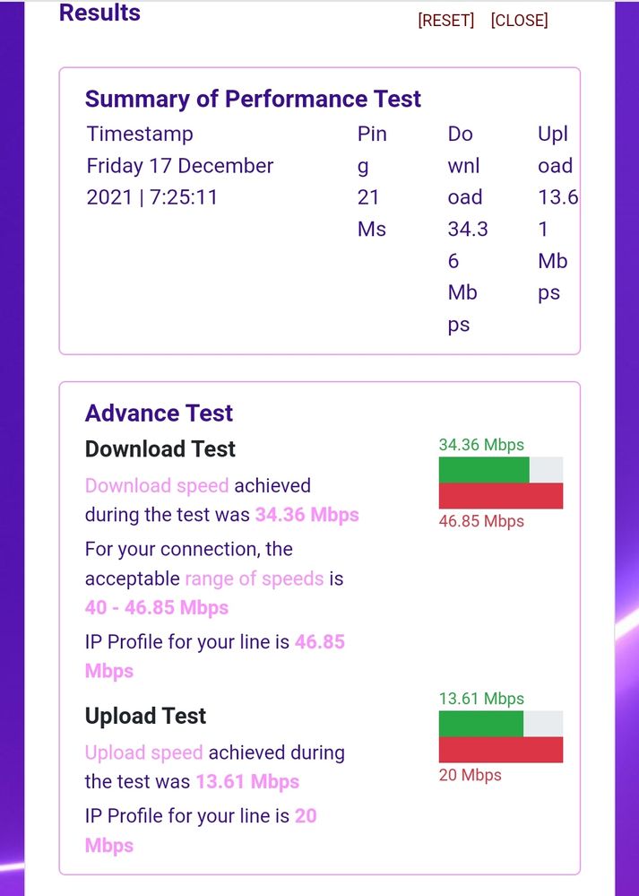

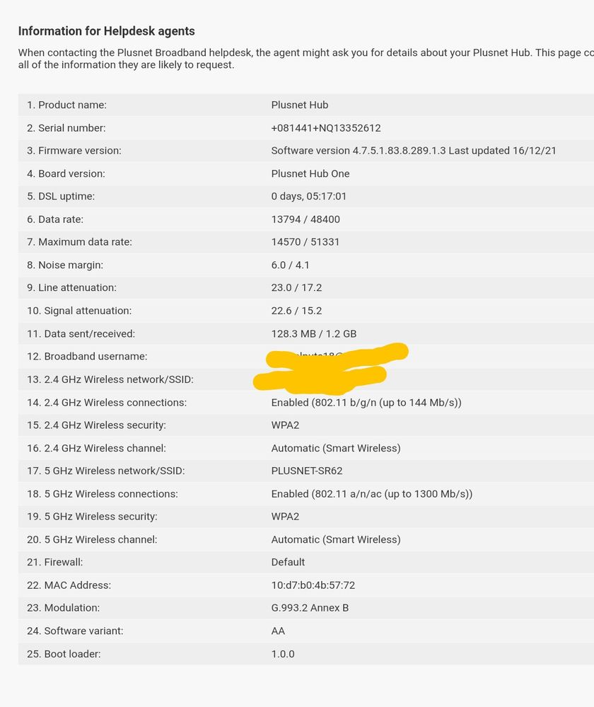

Just reran the speed test and speed is even worse this morning according to BT.
As requested here is the output of member centre, BT diagnostics and hub diagnostic.
IMG_20211217_073458~2.jpgIMG_20211217_072735.jpgScreenshot_2021-12-17-07-24-51-444_com.android.chrome.jpg

Is it possible to run these tests over an ethernet connection via a laptop/desktop - wireless results are deceptive?

Regardless of what the Plusnet portal says, we don't know how out of date that is, your Hub is reporting that it is in sync with a maximum data rate of 51331 Mbps and a data rate of 48400Mbps.
Consequently I think that what needs addressing is why your speed test is only achieving 34.36Mbps.
How are you testing this, wireless or over an Ethernet connected link to a computer?
If wireless then what do you get if connected via Ethernet?
Have you tried a different speed tester?

@Baldrick1 All screenshots were taken this morning when posting.
I have tried a different device and speed tested and achieved 46Mbps.

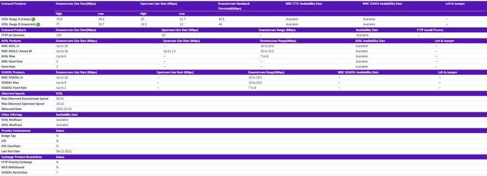

here is the output from BT Broadband

@Ajj81 My observations, for what they are worth: unless your FTTC cab is very full and having lots of cross-talk problems, I would have thought you should be getting better than you are, based on what the BT Broadband Checker is reporting and your attenuation figures. That checker reported 50.51 Mb/s on the 15th, and yet you are only seeing 36 ish.
Something doesn't seem quite right, but an ethernet connected test would make it a little clearer where the issue may be.

Line tests aren't showing any causes for your slow speeds or cross-talk at the cabinet either, and I can see you're well below the estimated speed range for your line as shown Here of between 59.2mbps to 78.9mbps.
