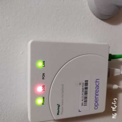

When we got back today we found the FF off and lights non the BT thingy with a red light on POS and the light next to it off.
This must have happened two days ago because I haven't been able to contact my Ring doorbell for that time or my CCTV cameras. the router shut itself down which was helpful.
Anyone any ideas? Because I have tried resetting and all other manor of reboots but nothing just dead. I take if there is no ticket raising, because I like to have it in writing, anymore.

@nevgeorge The red LOS light means 'Loss Of Service'. You need to get PN to ask Openreach to investigate.

Day 7 without Full Fibre, the LOS Red light on the ONT has gone out and now the PON is Green is going on and off, Hub 2 is Orange.
Tried it with new cables, another Router TP 1500, reboot all several times. Managed to get into both Router managers to try and connect from there....Nothing!

TBH, it sounds like progress is being made. Flasing green is the ONT attempting to connect.
