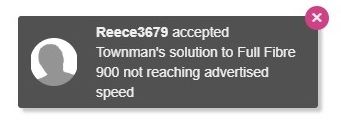

Edited to add:   @Reece3679       20250828-1727pm-comm-site-solution-accepted.jpg
 Thank you Smiley
