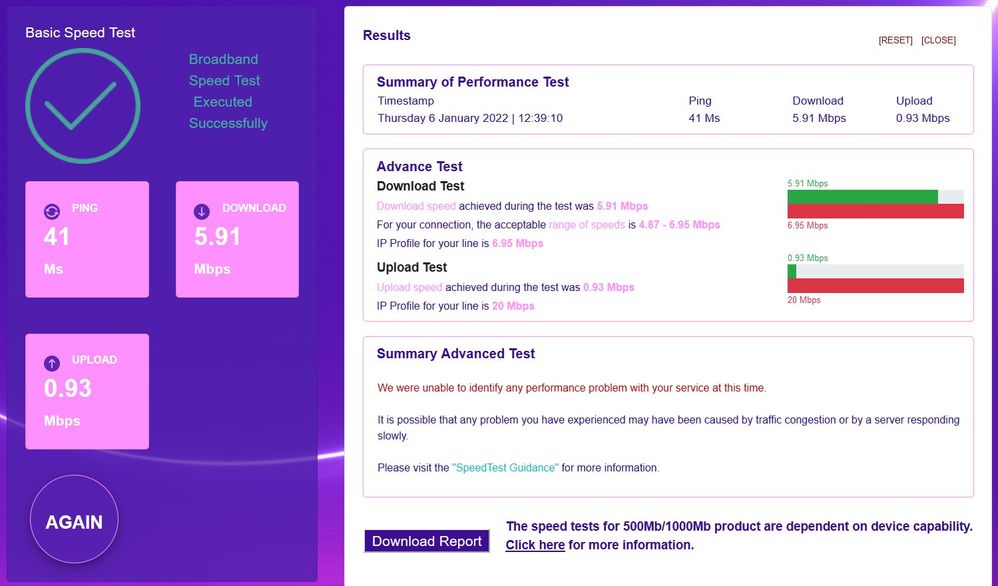

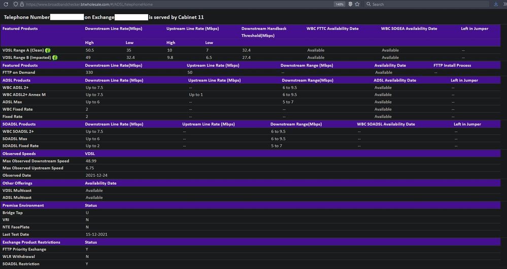

I've been seeing some dropouts on my connection since we had it 'uncapped' in mid December. Last night after it dropped it returned at around 6mb. A power cycle fixed this, but it has now happened again. The connection was relatively stable before this, and my configuration has not changed. Picking up the phone it seems there is heavy crackling on the line (the line is never otherwise in use). Speedtest and stats are attached.
Could someone please look into this?
