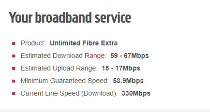

Re: Fiber Install Complete
Here's what I see
Think product hasn't changed yet.
Posts: 20,458
Thanks: 9,293
Fixes: 585
Yes, the product change hasn't completed yet. It should complete later today, keep checking occasionally and once it shows Full fibre, then reboot the router.

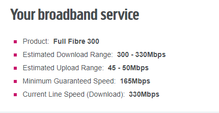

Got the email about product change being complete. I checked the site and yes, it's changed there too
Do a speed test and I max out at 94. This is a wired connection.
