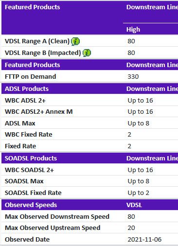

@Gandalf My line has been a constant 74.5 down for the last two months, although I've noticed some bizarre behaviour with it yesterday, my BT wholesale max observed has reset to 80-20 and yet my line speed now averages about 71.
I have naturally conducted a line resync by switching off the router and modem with no improvement.
Having run a speedtest direct from my router it reports a 100% loss; I believe nothing has changed my end and so I'm wondering is there a fault on the line?

Thanks a lot for reaching out. Given the nature of the Openreach network, line speeds can fluctuate from time to time, it's really normal. I've run a test on your line this morning and can see that it's syncing at full capacity.
KBD
GEA Test Detail
Circuit ID NA Service ID
Test Outcome Pass
Main Fault Location OK
Sync Status In Sync
Downstream Speed 80.0 Mbps
Upstream Speed 20.0 Mbps
Appointment Required N
Fault Report Advised N
NTE Power Status PowerOn
Voice Line Test Result Pass
Cross Talk Not Detected
Estimated Line Length In Metres 205.3
Upstream Rate Assessment Very Good
Technology VDSL
DP Type External
Profile Name 0.128M-80M Downstream, Error Protection Off - 0.128M-20M Upstream, Error Protection Off
Time Stamp 2021-10-25T10:30:00
Parameters MIN MAX AVG
Down Stream Line Rate 79.9 Mbps 79.9 Mbps 79.9 Mbps
Up Stream Line Rate 20.0 Mbps 20.0 Mbps 20.0 Mbps
Up Time 662.0 Sec 900.0 Sec 899.7 Sec
Retrains 0.0 1.0 0.0

I’d also bear in mind that the IP profile is typically between 90 to 96 % of a sync speed and your throughput a little lower due to overheads of the connection as well as particular settings which DLM may have applied.

Thanks for the feedback it is very much appreciated, so as my line with you guys is set at 78 I wont see a great deal of difference while it is set at maximum with OR?
