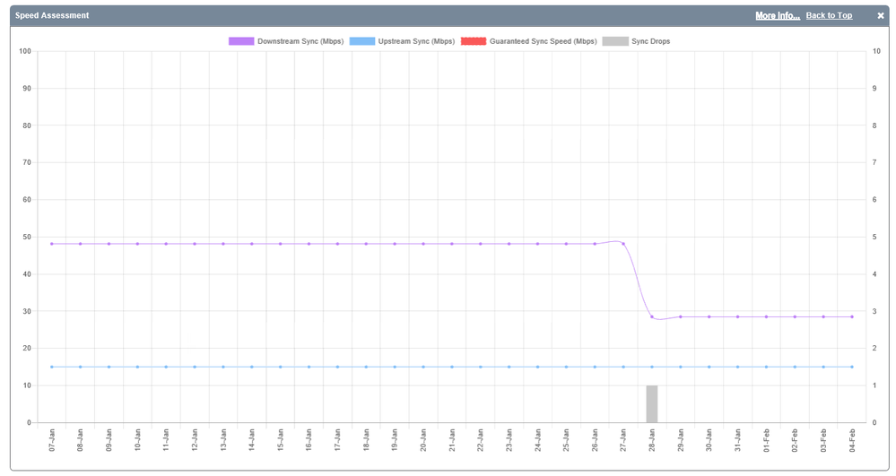

Hi,
Speeds have dropped markedly over last couple of weeks. Just ran BT speed test and additional diagnostics. speed and IP profile about half what should be (see attached). How do I get this fixed please. hope it isn't another issue with this dodgy line!

04-02-2022 11:49 AM
Further diagnostics attached

Re: D/L slow speeds and IP profile halved
04-02-2022 12:04 PM
Ok - I would raise a fault - you are below even the 'Impacted' Hand-back threshold, so there is a problem.

04-02-2022 4:30 PM - edited 04-02-2022 4:44 PM
Thanks for getting in touch @PhyllisTyne
Bit of a strange one this, there was one drop on the line which occurred on 28/01/2022, which resulted in the sync speed plummeting. The DLM profile looks fine, but our internal L2TP profile appeared to be stuck at around 28Mbps.
I've just reset this on my end, can you run another speed test (preferably wired) in an hour or so and let me know how you get on?
05-02-2022 11:12 AM
Thanks for getting back to me @PhyllisTyn, I reckon we ought to raise this with Openreach now as sync speeds on our end are still really low. I've just created a ticket on the account which we'd need you to respond to, stating your availability for an engineer visit.
Let me know when you've responded and I'll get it raised. ![]()
