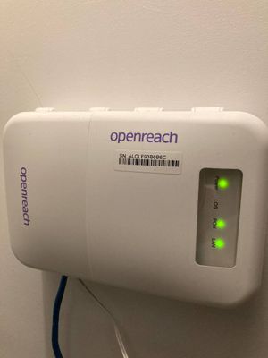

Maybe @takumipui could post a picture of the Openreach box in question just to confirm what we're dealing with ?

This is the openreach modem
update: I have used the plusnet hub 2 router for the last couple of days, it takes the WAN port from the openreach to do the connection and my router is on LAN static ip with DMZ setup.
I notice the WAN connection drop when my VPN disconnected ( I have work VPN on all day long, this is the reason I really want to fix it ) then I went in to read the "technical log" from the hub 2 router, nothing shows, not a single log message about WAN disconnected.
I tried to call 0330 1239 123 but it always redirect me back to sms bot, then I tried to type "REFRESH" to sms bot, then I saw connection log in the hub 2 , some CWMP logs and I think it did reconnected.
I will keep this setup a bit longer for monitoring but I will be away from tomorrow for a week, then coming back will try to reach support.
Thanks @MisterW @dvorak @jab1 @Townman have a look on this with me.

@takumipui you can export the technical log as a csv file. Post it on here and we can look to see if there are disconnections.
Is that actually a WAN disconnection or possibly the DNS servers being reset when the VPN drops ?
