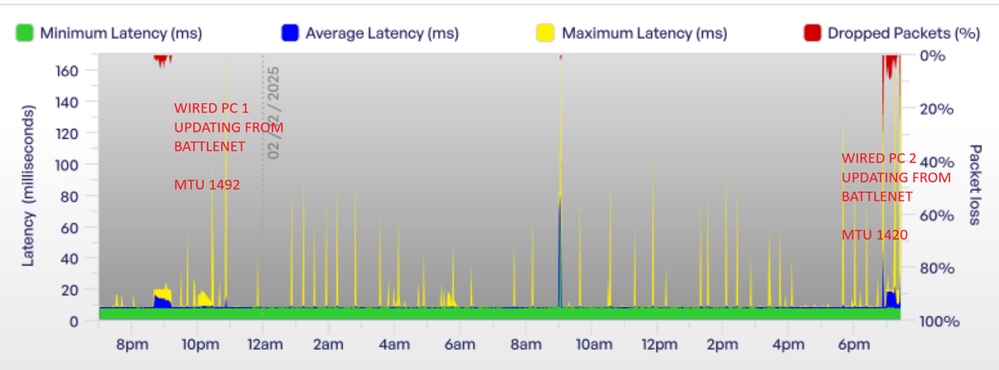

I've had a ongoing issue since install nearly 2 years ago regarding packet loss mainly noticable when download game updates from battle.net or epic games content delivery servers.
I tried reporting the issue to customer service but they didn't understand. They arranged a Cube engineer at the time and 2 guys came out saw the issue and couldn't offfer any fix or quite understand what i was showing them. I showed the issue by using the plusnet router and also directly with a laptop setup direct to the ONT using PPPOE.
The connection and latency are generally great but as soon as an update is needed for a game the whole connection appears to act like a DDOS, all internet traffic and devices will suffer packet loss until the download is complete. We have a few gamers in the house so its starting to annoy other users now. I would expect the latency to jump higher as the connection is saturated not drop packets above 20ms.
I've factory reset the ONT, tried multiple routers (currently a Draytek 2865) and direct to the ONT with PPPOE. Upgraded from 500mb to 900mb. Tried QOS, TCP ACK priority, limiting download speed but unfortunately cant resolve it.

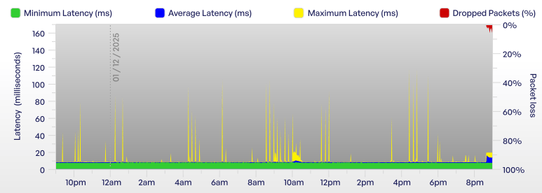

The think broadband graph always shows a hard cut off around 20ms and packet loss when it happens.
How can I reach the correct person at Plusnet to help?

Hi, I previously tried a few different MTUs but i gave 1420 a whirl but had the same result. The longer packetloss spikes near the end of the graph is me rebooting the router to make the change.
This is different gaming pc updating from battlenet also causing the packetloss. The PCs are all wired by the way.
I think its a change needed at plusnet but I can't seem to raise the issue to anyone that does more than run an openreach test (which obviously passes)
