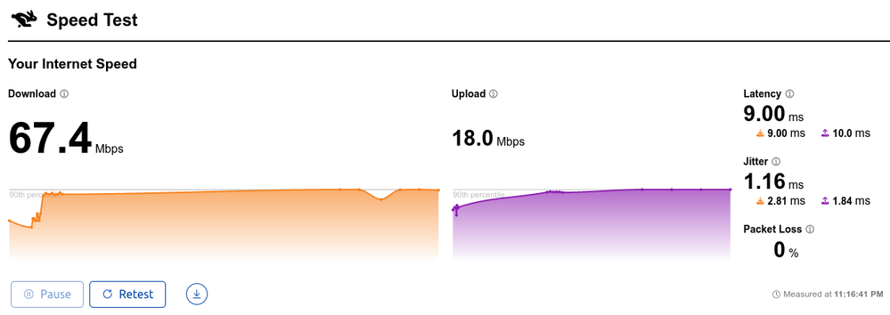

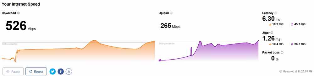

For clarity, this is what I'm currently getting on my Plusnet connection:
And this is my failover with another ISP:
I don't believe this is intentional, hence the use of the word "seems". However, I would like some clarity if someone with the real technical knowledge is able to provide it.
