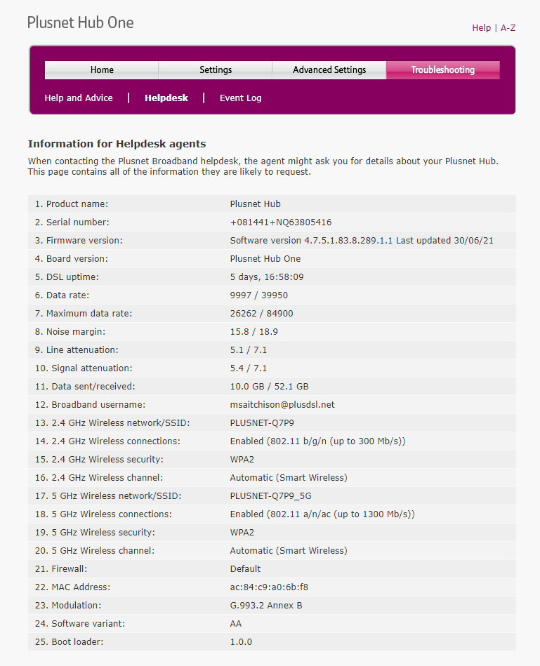

@Aitch21 Welcome to the forums. Two suggestions - (1) dial 17070 from your landline, select option 2. After confirming your phone number, the only thing you should hear is the 'Quiet Line Test' message - any other noise at all, report a phone fault first.
(2) Post the results from your router Help Desk page - it may give us an idea.

Thanks John, quiet line test seems quiet.
Sorry for being dumb - how do I find my router Help Desk page?

Does this picture help?:

Thanks John, I've got this

@Aitch21 Thanks for that screenshot, I note the connection has only been up for a short while - have you had multiple total drop-outs? Your Attenuation looks as though you are mightily close to the cabs?

OK, @Aitch21 Continuous multiple resets could upset the Dynamic Line Management, although apart from the SNR values looking a bit - which could be due to your closeness to the cabs, and therefore not a worry, I too can't see any reason for your issues.
Another thought - are you on a 40/10 or 80/20 profile, do you know?

Thanks @jab1 . Sorry, what do you mean "closeness to the cabs"? Does this mean that the router is too close to the electrical wire?
Sorry, no idea about the profile.

No, 'closeness to the cabs' means that I suspect the BT 'green boxes' must be almost outside your house to give the figures on the Help Desk, which is good.
