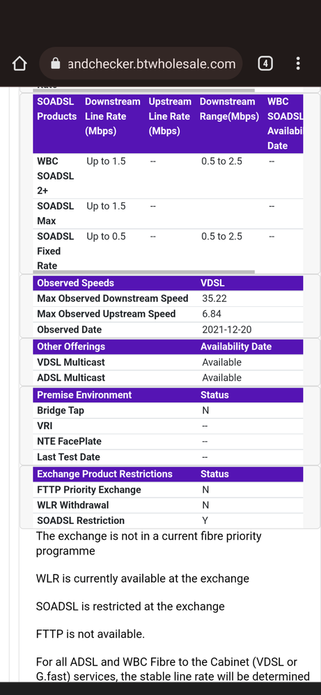

I've added images of results to my gallery but can't seem to post them here. I can't do the wired test ATM. Thank you!

Re: Broadband dropping out, new router?
No access to a PC is unfortunate - the resulting lack of width makes the data hard to read, but I'll do my best. From the ADSL checker in the above post, it appears that you closish to the VDSL cab, but strangely you are not offered the 80/20 product - don't quite understand that.
The other details I requested may throw some light on this, so I shall await them before commenting further.
