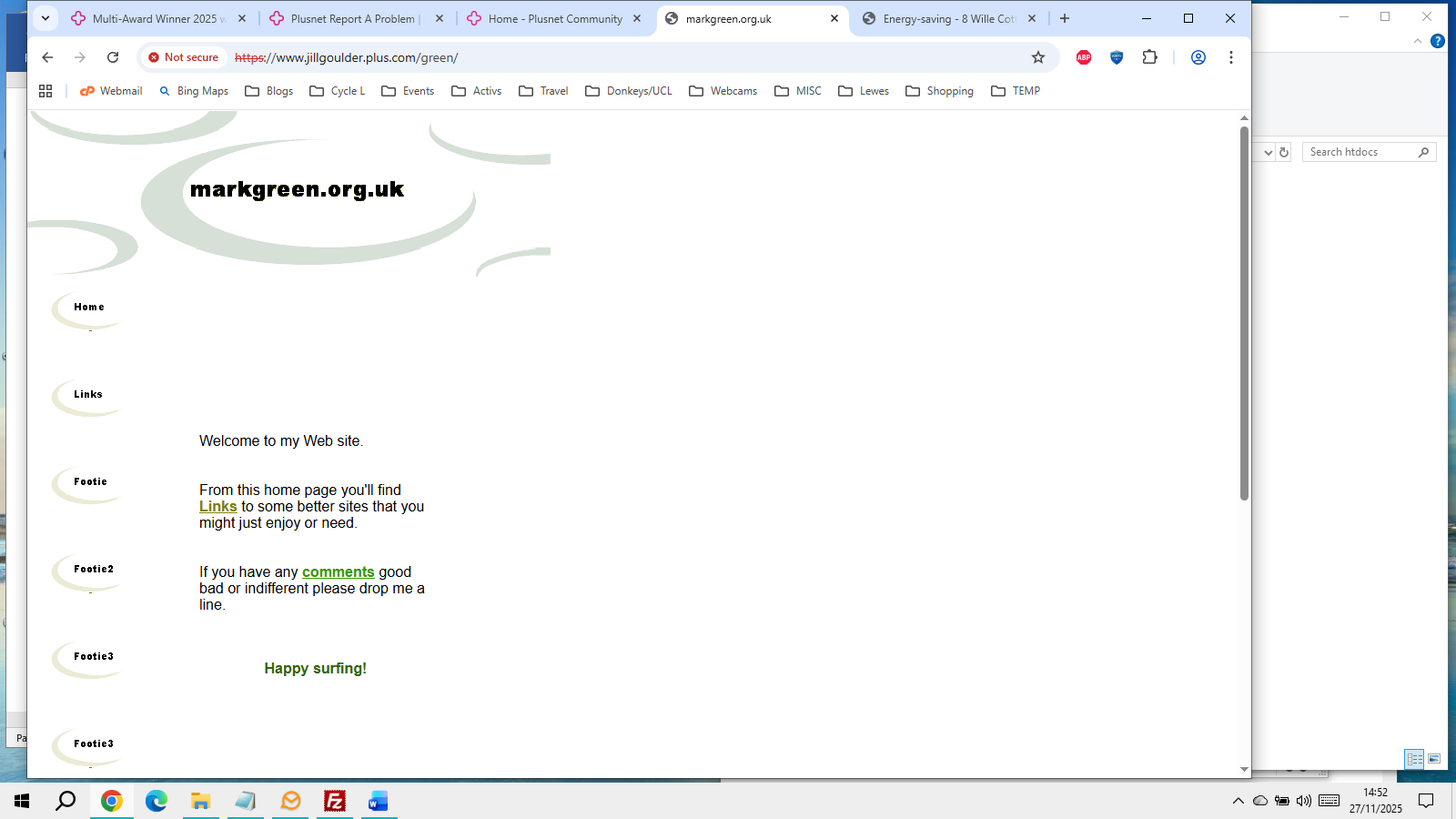

I know that Plusnet have been moving their email and web hosting functions to Greenby, though I haven't had account details from Greenby yet. But suddenly I'm not able to see most of my sites on my PC or phone, though friends can see some of them. I suspect it may be a security problem, re https. I rang Plusnet, who can see the sites on their screen, but who don't support websites any more. They opened Question 251704569, and suggested that I tell my problem to the Plusnet community, so here I am.
Mostly the sites come up as not found, though in one case, www.jillgoulder.plus.com/green, a completely different website pops up on my PC (screenshot attached, I hope); but on my phone I just get a Vodafone security page.
Happy to pay for expert help if anyone can recommend! I'm not at all techie about internet, even though I write my own websites.

@JillG   Your Website is displaying perfectly correctly on my Plusnet connection and from general info on the forum no emails or websites of the xxx.plus.com brand have yet been migrated to Greenby. So Plusnet should still be supporting it, what is the point of raising a question if they then expect the forum community to deal with your problem.
It looks like your problem is related to your own internet connection rather than your website, are you able browse other websites normally?

No problem at all with displaying any website except my jillgoulder.plus.com ones, on my PC and my phone.
Progress - after an hour on the phone to Plusnet... They initially said that they'd never hosted my sites, but now agree that they did. Apparently another company, www.enom.com, is now hosting them but I should contact Plusnet if I have problems! The problem with some visitors suddenly, from v recently, being able to see my sites and others not is probably due to settings in browsers etc; something about the websites, since very recently, is setting off security blocks with the devices that I'm using and not with some other people's devices; so the host company has different sensitivity settings; but I can see that I have to give up on running that one to earth. So I'll have to live with not being able to view my own websites.

I can see both sites, depending on whether I got to http or https. That is all straight forward and working/
The Enom bit puzzles me - do you have a domain? If not, that's good (except the support). If so, it's on a different account. If you do please PM me the domain.

Thanks. It's very puzzling; I've been able to see all my Plusnet sites on all browsers for years (i.e. typing the url into the bar at the top), and suddenly I can't. The page that I get to on my PC is a Not found one, or for the /green page it goes to a completely different website. On my phone, the page that I get to is the Vodafone Secure one. So the block seems to be because they're not https sites? So the browsers (all mine and some other people's) have suddenly become fussy? But if I search on Google and look for the site in the answers, I can get to it 🙂.

Forget Enom for the moment, what you're actually looking up is plus.com.
It seems, for, whatever reason, there are two versions of your site, one at http and one at https.
On the 'wrong' site is a domain name (an org.uk). Is that your domain as this might be the key to the situation.
