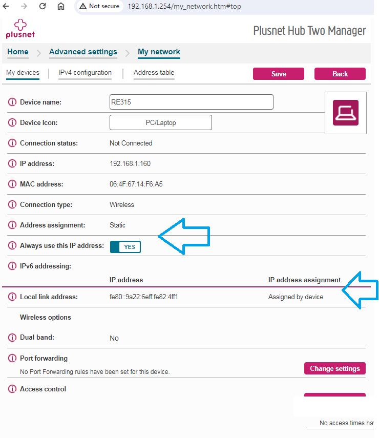

I wanted to share some more info about this that I've discovered.
The plug above isnt a powerline adapter its a range extender. Another tenant has another one slightly different tp link rnage extender.
The are both using them in their rooms, which i tried to explain to at least one fo them that its pointless to do that because its only repeating the signal that is already in that room.
It seems that what was happening is that both of them had dhcp set to auto and both of them were calling themselves the same name routername_ext. So I've changed the name of one of them and they both now have dhcp set to off.
So that is part of the problem solved.
The issue is not gone yet though. There is another device, a samsung galaxy watch that seems to have a static ip forced by the plusnet two router. I cannot change it from static to dhcp nor disable the checkbox that says "always use this ip". The plusnet hub two router is also forcing static ip "always use this ip address" to random devices such as my pc and ps5 intermitently.
It seems that the galaxy watch needs to have wifi turned off because it is also trying to be a hotspot and using dhcp which is confusing the plusnet hub two router. So im making progress, I know nothing about these watches but its next on the hit list for a damn good tweaking.

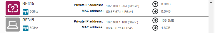

The DHCP against 192.168.1.253 means the Hub Two DHCP thinks it's providing the IP Address not that DHCP is turned on on that device.
As previously mentioned  both RE315 have there DHCP server turned off to prevent any duplicates

you've touched on something there because I hadnt really realised that there are two of those, that clearly shows two different mac addresses so there must be another one. Sometimes it shows two of them, one for the 2.4ghz and one for the 5ghz, but they are both 5ghz with different mac address.
The fact that none of them have been set up at all, they all want to be called router_ext, which i thnk maybe what this is all about. If they all have different names, as well as having the dhcp set to off, not auto, then hopefully all will work ok.

@Cuppajoe
On reflection this is probably the same device as the MAC addresses are very close. I've used a TP-Link One-Mesh RE300 in the past I have noticed a device created MAC address close to the device actual hardware MAC Address.
On this RE315 the device created MAC Address is (06:4F:67:14:F6:A5) based on one of the RE315 hardware MAC Address (00:5F:67:14:F6:A4).
Unfortunately  I can not remember under what conditions this local MAC address is created and used.
